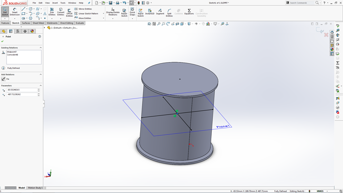

hi @tinaalim,
here is some example.

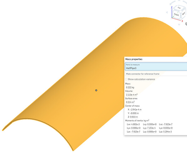

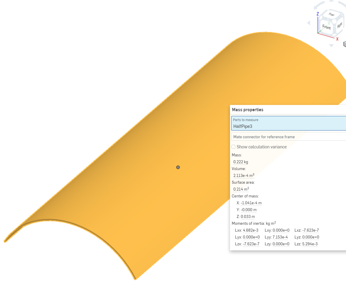

With OnShape you just need to assign a material (any) to your geometry, select that geometry and click on small button which appears in lower right corner of the window (hovering the cursor over it will popup 'Display mass properties").
If your center of rotation is not the mass center, this is up to you to find it out.
