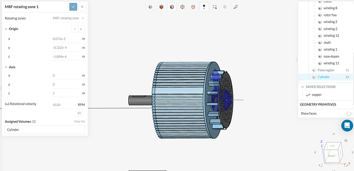

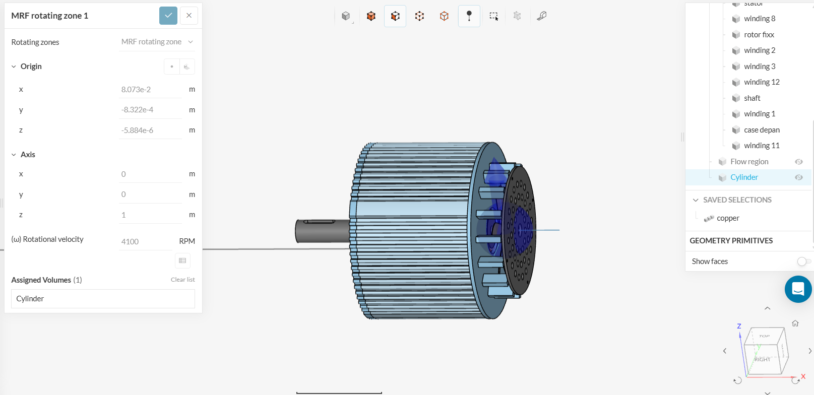

The heat distribution on this motor is not normal, and the fan does not rotate as desired towards the motor.
link project = FAN NOT SPIN

The direction of axis specified for the rotating zone looks incorrect to me.
It is specified to be in +'ve Z direction, which means with right hand rule the rotation of the fan does not make sense, the axis of rotation should be the same as the fan axis, in this case, X direction. + or - depending on which direction you want the fan to rotate. See this part of the rotating zone article.
Other than that, MRF is an approximation of the rotating effects induced into the flow region that intersects with the assigned MRF zone. It does not actually move the blades of the fan.
