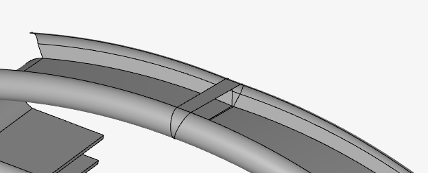

There are some errors when I uploaded my CAD model in Simscale. The model isn’t loaded properly. More exactly, the part made with SWEEP tool isn’t loaded at all.

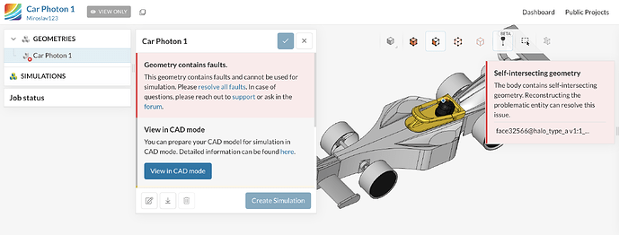

Here it is the model in step file format. Unfortunately I had different error with another part of the final assembly. In the link is the virtual cargo file which had several errors. It couldn’t be even loaded in Simscale. Can you please help me resolve the problems. Unfortunately again, I cannot open the virtual cargo file on my PC because it is from newer version and by the regulations of the F1 in schools competition it MUST NOT BE CHANGED at all.

Hi again @Miroslav123,
Thanks for sharing that one! There were some issues in the CAD model that I have solved, and I have created a new project where there you find two models ready for simulation (one in .stp and another in .igs), you can use both it is up to you :slight_smile:

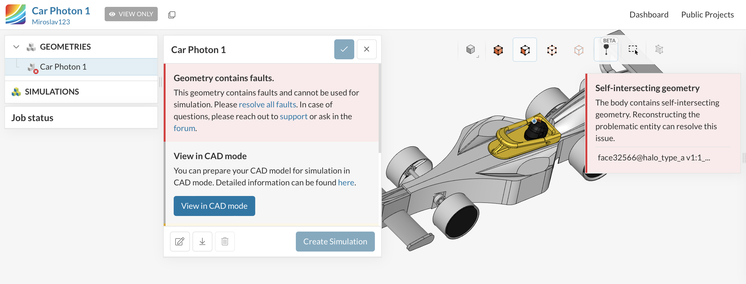

Thank you for your help Mr. Goncalves. I have shared the project with you. I have fixed the issue, but still can not proceed. Can you help me?

I tried to make new projcet with STEP files, but it couldn’t open at all, so the link below contains every part from the projcet only in STEP. Hope it helps

Hi @Miroslav123,
Sorry for the delay, I just saw many issues to fix in the geometry such as missing faces, small edges, intersections, etc. I have fixed that and I did a generic CFD setup just to give you the idea that now the CAD file is working well.
