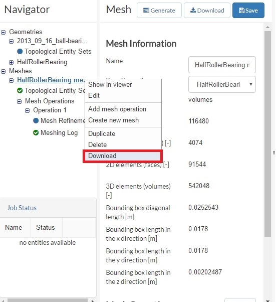

Hi Ed (@exp1) and first of all welcome to SimScale :wink:
You are able to download the Mesh as a .med file.
More information about the manipulation of meshes and fields and libraries that can be used in C++ programs as in python script for data processing on meshes and fields can be found here: Salome Platform Documentation
Does that answer your question?
