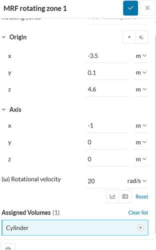

Error : Found 1 body only assigned to advanced concepts and not interfering with any body assigned to a material: Cylinder. Check your advanced concept and material assignments or the CAD model.
I am currently facing an error that I
don’t know how to solve … This error
suggests that there is a problem
with my cylinder , but as far as
I know I did all the necessary
to correctly prepare my CAD to the
CFD simulation. I attach useful
screenshots in the
following message, and I hope that someone
could help me. Thanks !
The issue is likely that you did not exclude the cylinder from the external flow volume operation. Have a look at this page, in particular figure 9.
