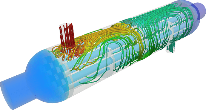

You might want to perform a setup similar to the one shown in this tutorial, just without the inlet/outlets modeling:
