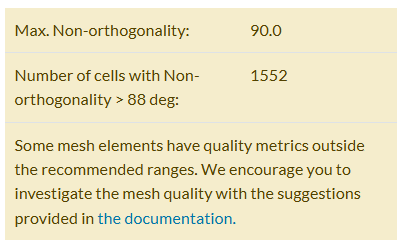

You can see the problem with the mesh in the event log itself. The non-orthogonality is outside the acceptable range. You can use the mesh quality tools to visualize or locate these cells and add appropriate refinements to fix the unacceptable parts.
