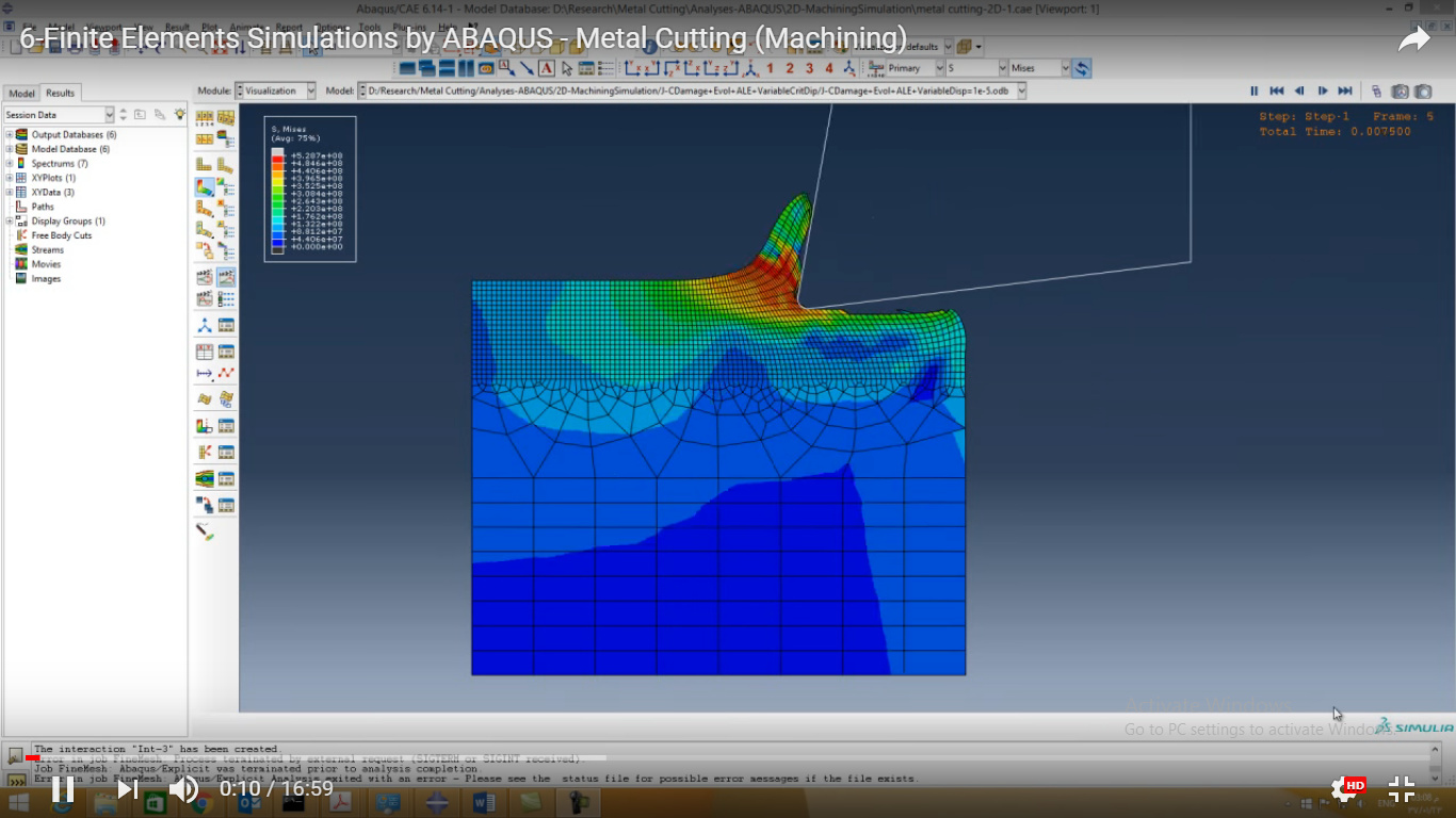

I needed some assistance in orthogonal cutting simulation and finding forces acting on the tool body. I Want to know can i perform this type of simulations in simscale, as i didn’t found any similar template in public library
Example video:
[https://www.youtube.com/watch?v=orFaMYWSHhA]
