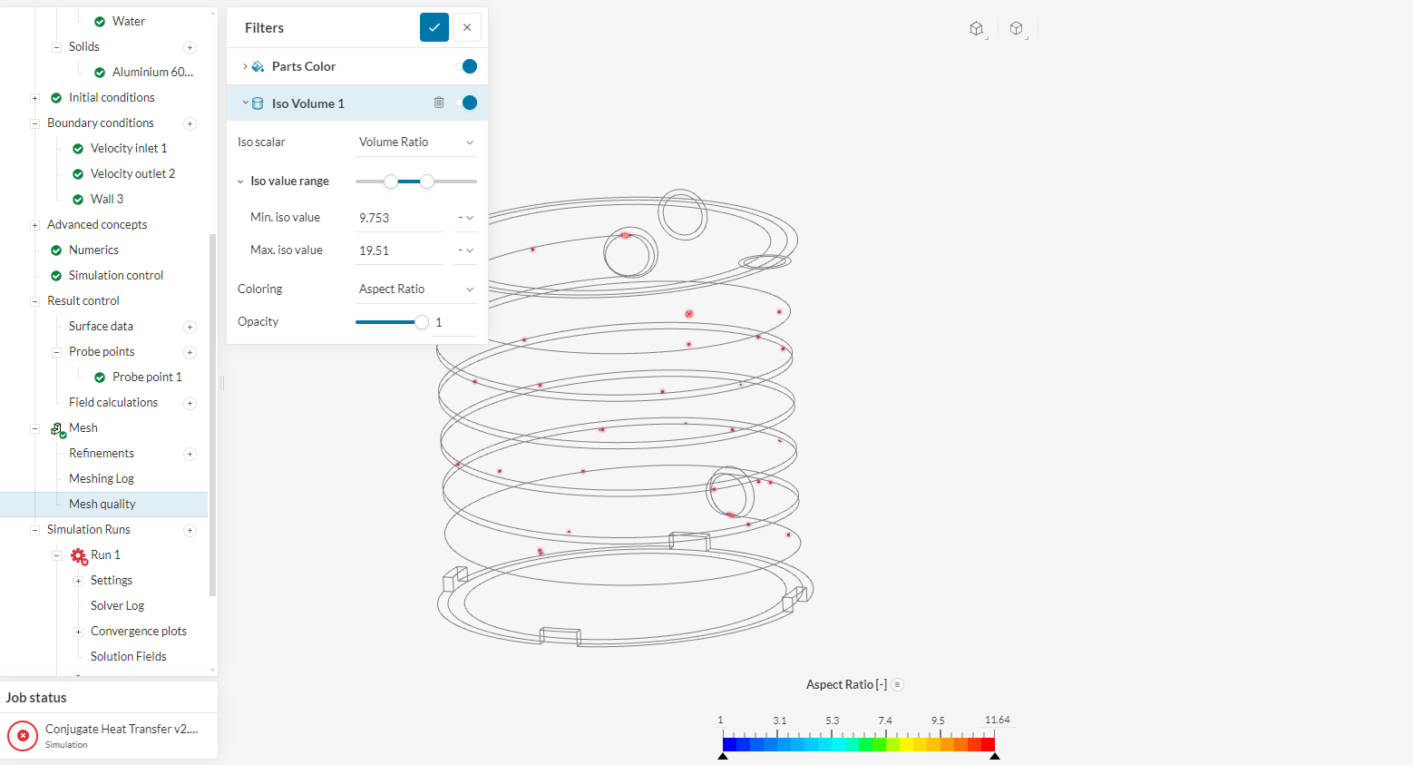

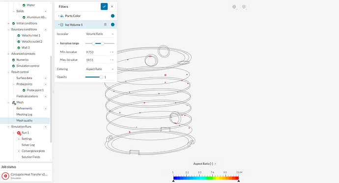

Hi @jmenear,
Thanks for posting your question. Here you have the solution: Divergence in Simulation: How to Tell When and Where? | SimScale
best,
In this case, two main workflows are possible:
- CAD clean-up around the problematic region
- Improving the mesh settings (for example, by applying additional local refinement, or improving the small feature suppression configuration)
