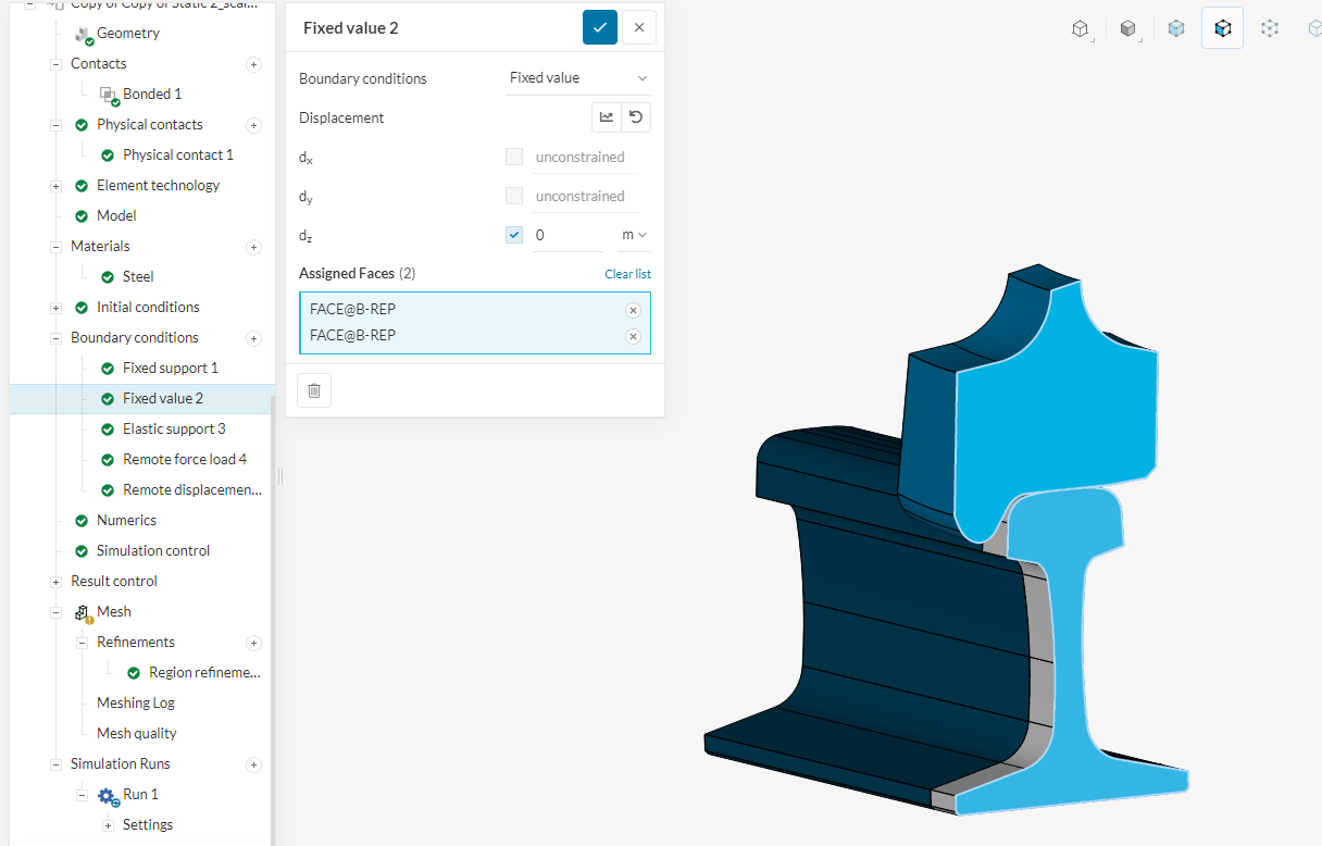

Try to solve a linear elastic contact problem of wheel-rail interaction. Geometry model imported as iges file. Use symmetry option in XY plane. The rail divide in to 2 part because of in the future plane to make mesh in contact region more fine. Face with symmetry options on wheel and rail constrained in longitudional direction. Two face on wheel constrained in lateral direction. Bottom surface of the rail fixed in all directions. Between wheel and rail physical contact. I tried to solve it in one step and with substeps. In both cases I recieved the same errors The solution matrix is singular at edge. Can`t understand what is wrong.

Hi, SBlock. I have read about the possible causes of the error, but cant find my error. The strangest that solutions matrix singular at the edges which belong to the rail. Rail have a fixed support. It can`t be unconstrained. Maybe you have some other ideas about possible reasons for this behavior? Thanks a lot!

I changed the fixed value to support to only include the top part, with that the lower part is not over-constrained and i was able to run the simulation.

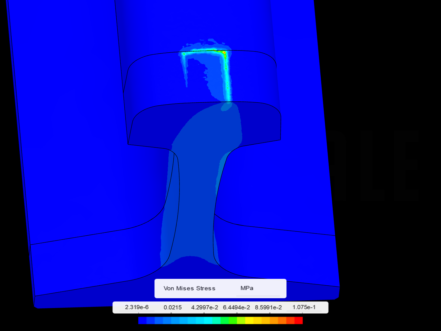

Hi, SBlock. Thank you for your help. Really, these steps helped me to finish my solution, but results look very strange. Maximum equivalent stress realized in the place, where will be no contact. May be you can explain me some things?
- Is it really correct to take away fixed value from rail in longitudional direction if there is a symmetry condition and could not be strain in longitudional dirrection? In ansys there is a symmetry or unsymmetry condition on the corresponding faces. How to implement it correctly in SimScale?
- You suggest me to use sliding contact, but according to Simscale documentation in can realize only tangentional contact. There are no stress-strain in normal direction. Solution of this example will look like hertzian contact with maximum equivalent strees in rail deeper on 3 mm from rail surface. As I saw in example with rubber wheel and ground, physical contact used there. May be you know what was wrong with physical contact in my example?

Boundary conditions.
Fixed Support for the bottom stayed the same.

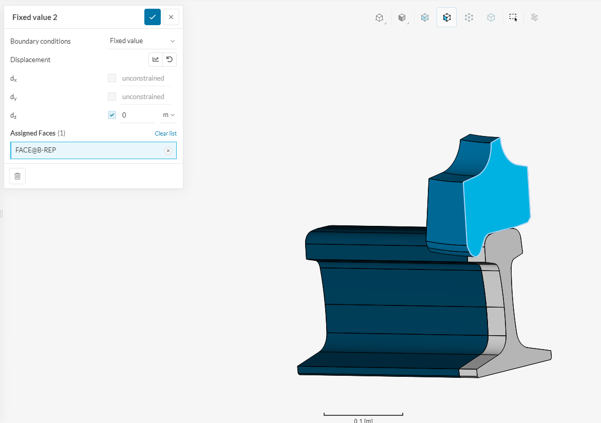

Fixed support in y direction for the symmetry faces

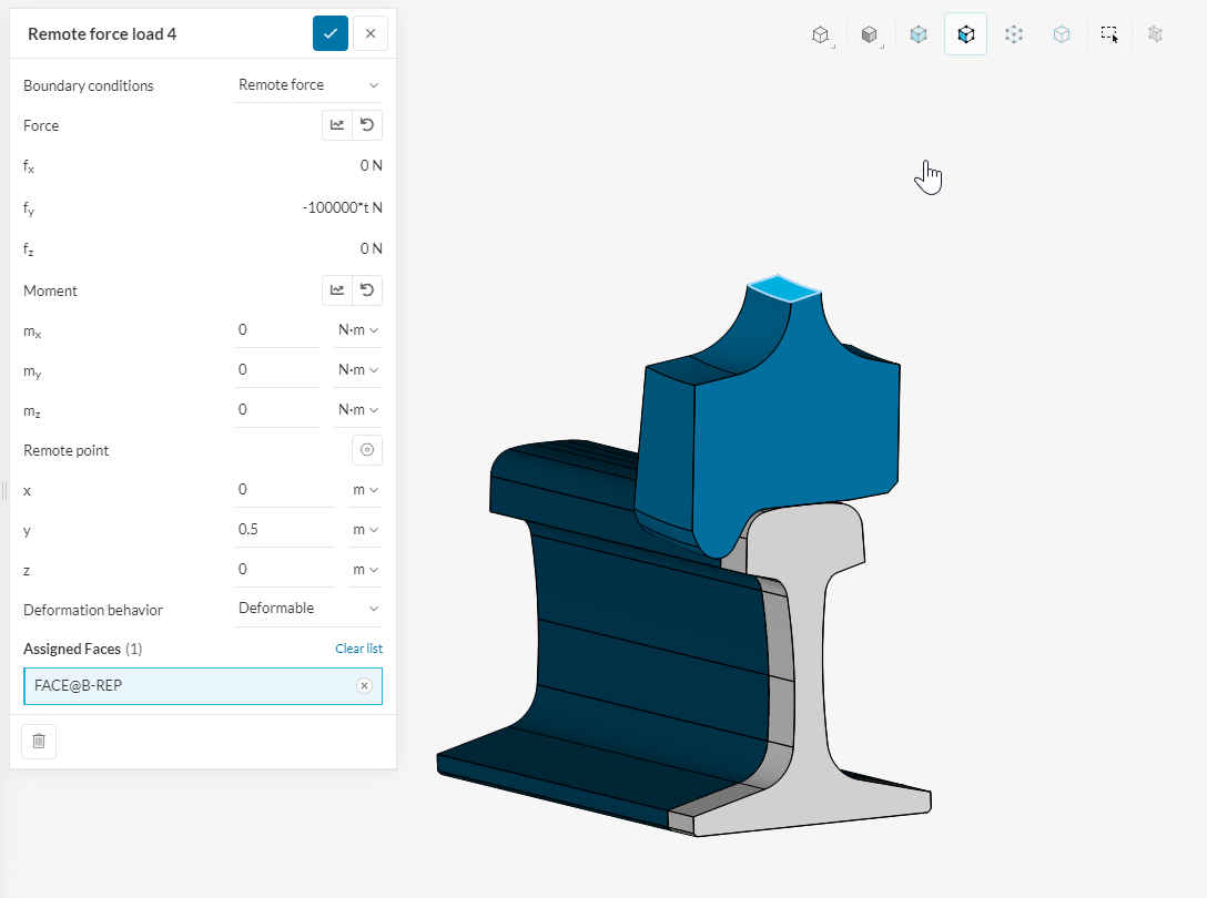

Remote Force definition in the center of the wheel, with the definition of a Formula to ramp up the Force application

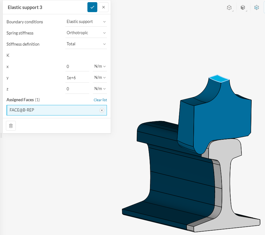

Elastic Support for the top face to stabilize the simulation.

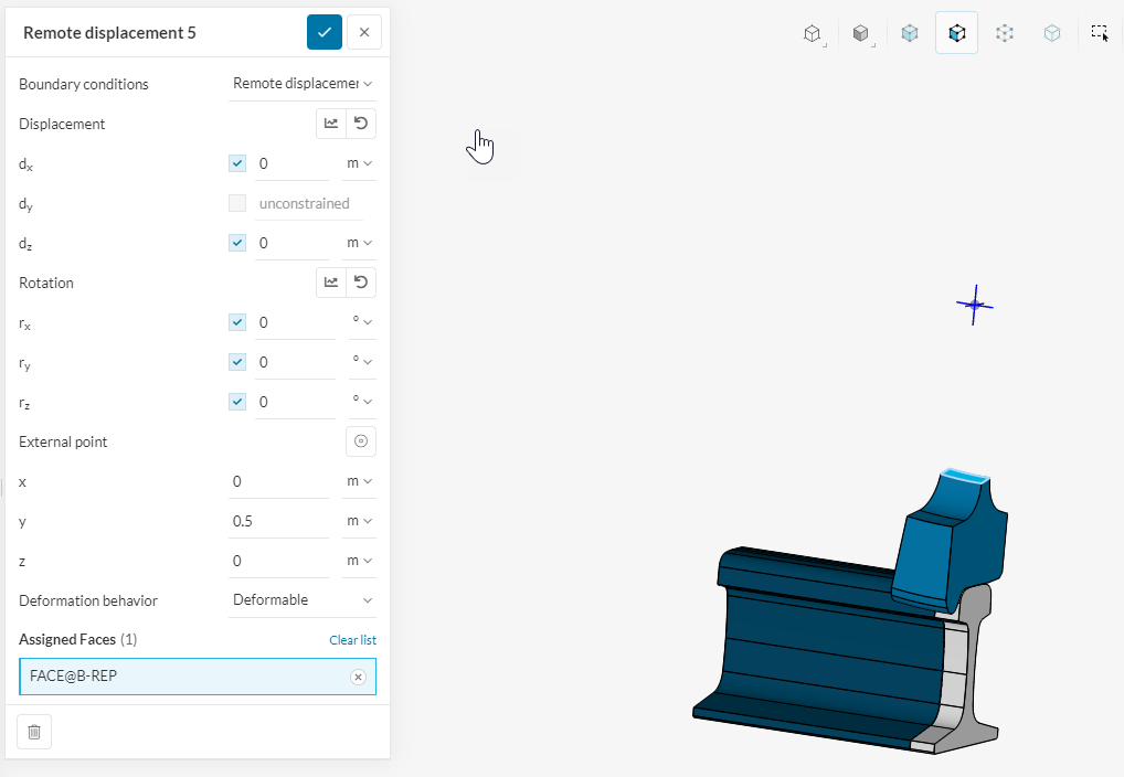

Remote Displacement for the top place limiting the movement into the y direction to further stabilize the simulation.

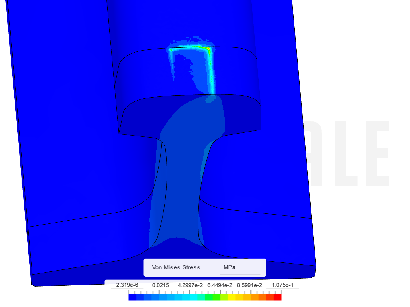

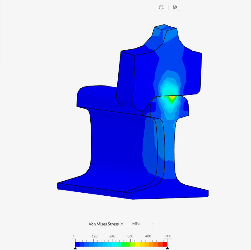

Lastly, we further activated the result control items for the contact results.
We further have the question of whether it’s okay for you that in this case the overall stiffness of the wheel and the weight of the wheel are neglected.
Here are some results of the stresses in the contact region. For a very coarse mesh.
