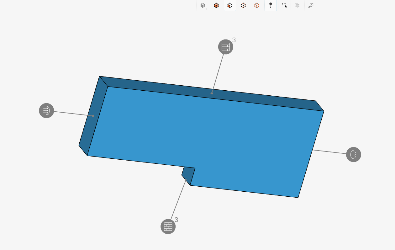

I am working on a compressible simulation of a backwards facing step, simulating at 30,000ft (Pressure 30kPa, velocity 180m/s, temp -44C).
I am struggling to setup the project for drag coefficient to be calculated.

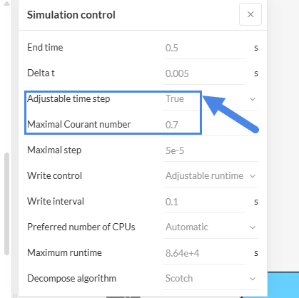

I can see that for most of your unfinished / cancelled transient runs, your setting for adjustable time step is ‘true’:
This forces the time step to be too small sometimes depending on the other specified parameters and can take very long especially for higher speeds like this. Note that this would only be sensible if you are really interested in the transient effects of the flow and not for steady-state drag.
