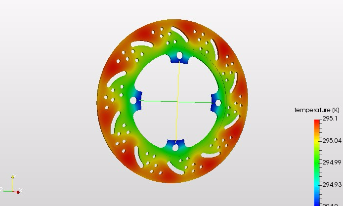

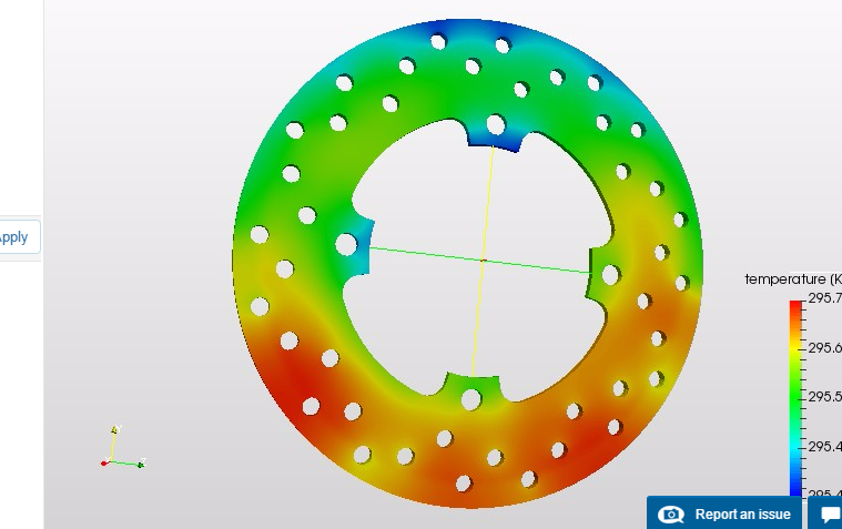

i had run thermal analysis on two rotor >they have the same description
transient and non linear ///
they have the same Q per unit volume and h convective heat transfer and same initial temperature
made from same material (steel )
post processing
how can i know which is better in cooling??
Hi @m1234!
First of all you don’t need to perform a transient analysis here. Your analysis is steady state and linear. Also it seems like you have different convection surfaces for both cases. In order to compare the results properly, you may need to consider similar conditions for both.
