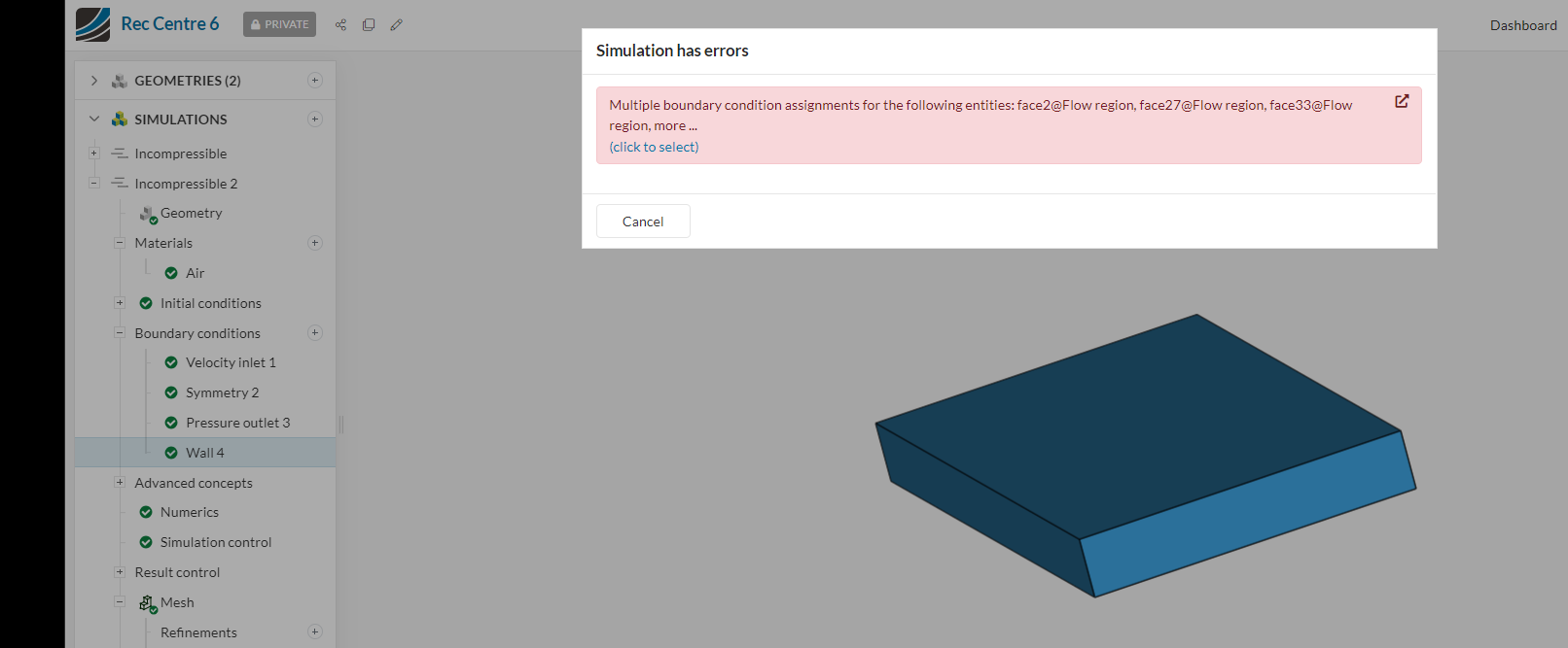

Can you please share your project here, so that we can have a look at it?
Thanks Sebastian - I’ll try and share my project with you!
Hello! It seems like you’ve assigned Wall and Velocity Inlet boundary condition for face2; also Wall and Symmetry boundary condition for face 27. Only one boundary condition should be assigned to each face for a succesful simulation.
