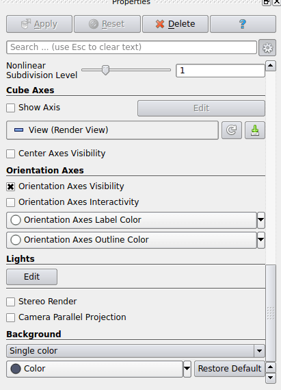

Regarding ParaView 4.3.1: As far as I know, the “View settings” moved to the “Settings panel” with one of the latest releases (see this blog post: http://www.kitware.com/blog/home/post/621 ). I am using PV on a linux machine and the option “Camera Parallel Projection” is in the settings panel under “View (Render View)” - see screenshot below (it’s almost at the bottom of the panel).
