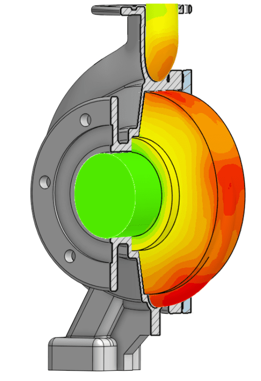

Please have a look at this tutorial on this Pump simulation.
Your setup should be the same except that you won’t assign a flow inlet and outlet condition.

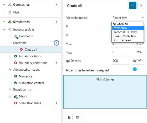

You can find an Article on how to set up a non-newtonian fluid here:
