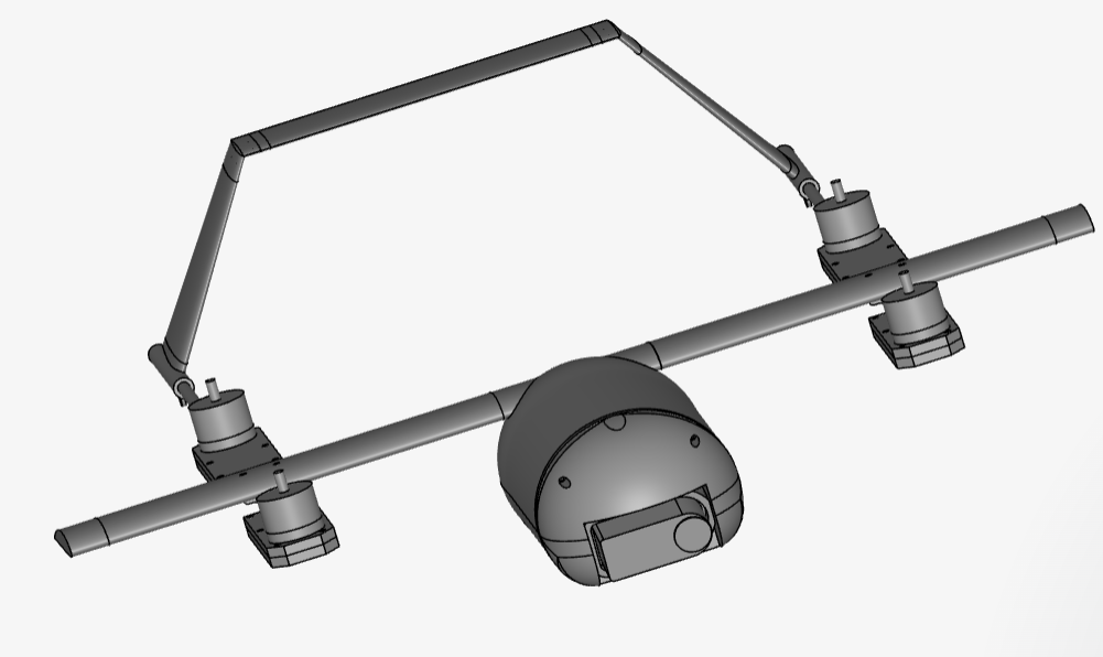

I am trying to test a drone imported from Fusion360 as an STL file.
Currently, the issue I need help with is:
“Automatic face split of facet bodies produced faces made of a single triangle. Please consider cleanup operations in your CAD tool.”

Hi @sverga, thanks for posting on the forum and welcome to the SimScale Community :handshake:
I think the first step should be defeaturing/cleaning your model: get rid of all unecessary details, small faces and sharp corners which would be a problem for meshing. Maybe these links are useful:
Importing the model as STL is indeed not a great alternative since faceted models don’t work well with the standard mesher. It’s preferrable to go for formats such as Parasolid or STEP instead.

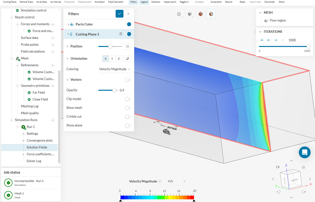

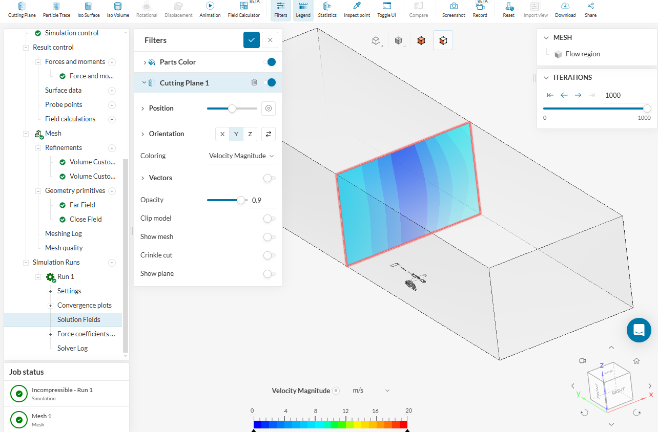

Hello! I have successfully run my sim, but now I think I made an error somewhere concerning the results, as seen in the screenshot attached, I am not sure if it is due to wrong values being inputted, or something else.
Hi @sverga, thanks for the reply! Please add a project link in this case for us to take a closer look at your simulation. Take a look here to learn more about how to share your project.
