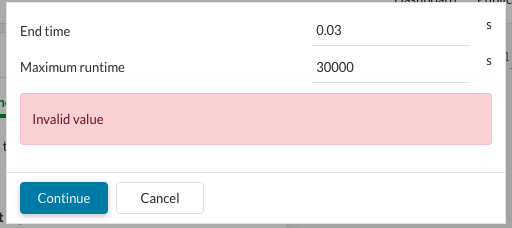

I am trying to use the feature continue run after a run finished. I assume that it would use the result from that run and continue. Someone else has this problem and it was solved Can't continue Run more than once
Regardless the value I put in End time (which I made sure it is larger than the end of the previous run)
Did I understand it incorrectly?

I’ve been extending a few of my simulations today and I’ve had no issues, but they were on simulations that didn’t have an error message. I looked at your numbers for your simulation for the End time of 0.03 & 3,000 both look ok to me.

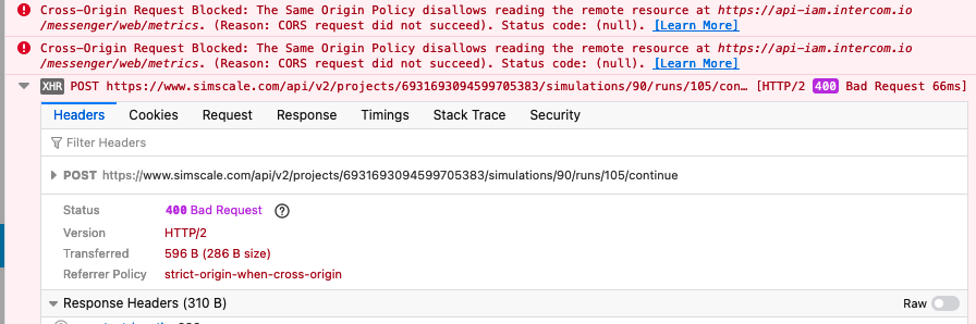

Thanks @TedBurke. I think it is a bug of Simscale. When opening the browser console, it says that it is a bad request for cross origin request. Is it possible to raise it to the IT? I have messaged some of the support engineers.

It appears that the end time currently needs to be an integer, so setting it to “1” should work.
I do foresee this causing trouble for transient runs though, so I’ll log this internally with the team. Thanks for reporting!

That was good idea looking at the browser console, I’ll have to remember that one next time. :slight_smile:
