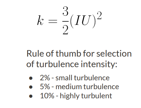

Turbulent Kinetic Energy (TKE), k

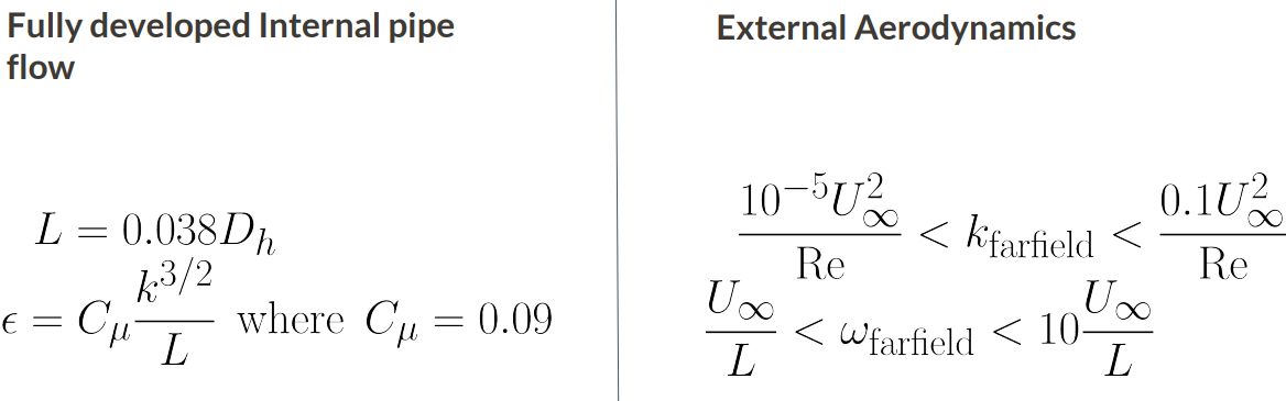

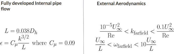

Evaluation of turbulent dissipation

So, for an impeller I=0,1, or?
Hi @vivien. Very much depends upon your setup. For an impeller you are probably drawing fluid in through a pipe, in this case you could calculate turbulent Intensity from the formula highlighted in this article:
Defining Turbulent Boundary Conditions
equation 4.
Darren
