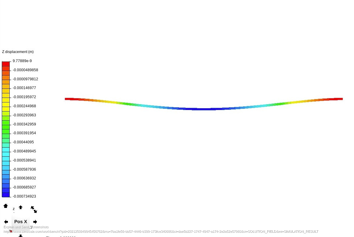

Hi @wmay,
I made a simple model and activated the gravity in the dialog shown below.
I fixed the ends and the effect of the weight shows in the results.
Is this helpful?
Christopher
Forgot to mention that option, thanks a lot Christopher for stepping in! :+1:
All the best!
Hi Christopher, jousefm,
thanks a lot.
I was not aware of the gravity option in model.
Knowing all model options obviousely helps ;).
regards
Wolfgam
