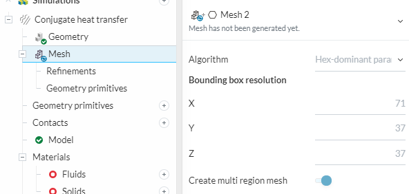

this here is an example project to show you what I mean:
Without Activating “Mutli Region Mesh”:
After Activating “Multi Region Mesh”:
So Just by clicking on “true”, my Background mesh Box disappears. And from that point I am not able to change the dimensions of my background mesh (when I got it right). I can just change the number of cells of each direction. But that is a little useless, when I dont see my Background mesh Box, isnt it?

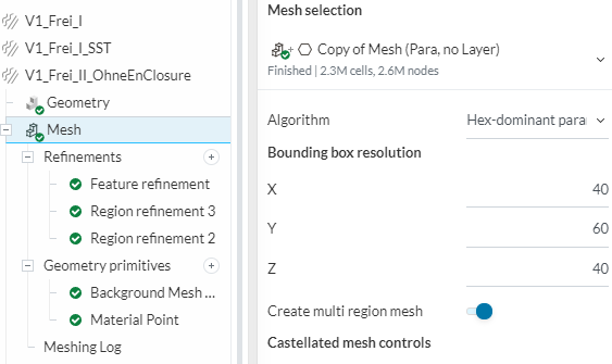

A little annotation:
This here is a screenshot of an other project. I did this mesh yesterday. And the confusing fact is:
Here the "Multi Region Mesh " option is activated, and although my background mesh is still where it should be.
When I now switch the option Off and then again ON, the Background Mesh Box dissapears like a freaking ghost…

Hi Malte!
So there has been a change regarding multi-region meshes. The bounding box and material point are irrelevant!
When activating the option you do not have to do anything else - hope that small explanation helps a bit.
