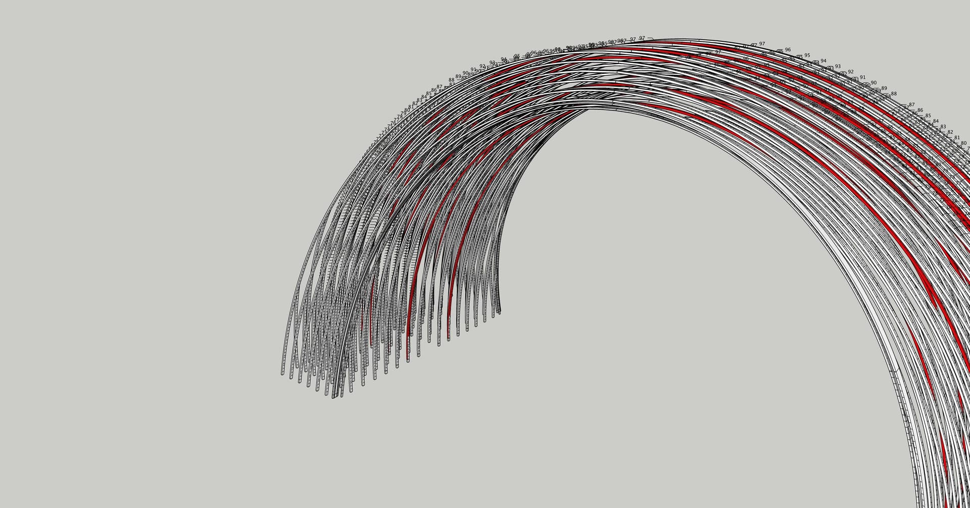

This is the interior column set:
Hi @ssbaker305!
No, at the moment this is not possible on our platform. We would keep our users up-to-date when we will release this feature in order to attack such kind of problems.
