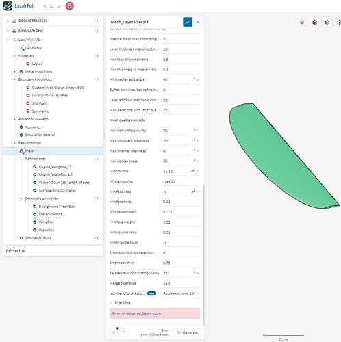

"An error occurred" during mesh generation of Hex parametric external type
Wow, I hope I don’t look too inept for not being able to figure out this one. I don’t see a mesh log being generated.

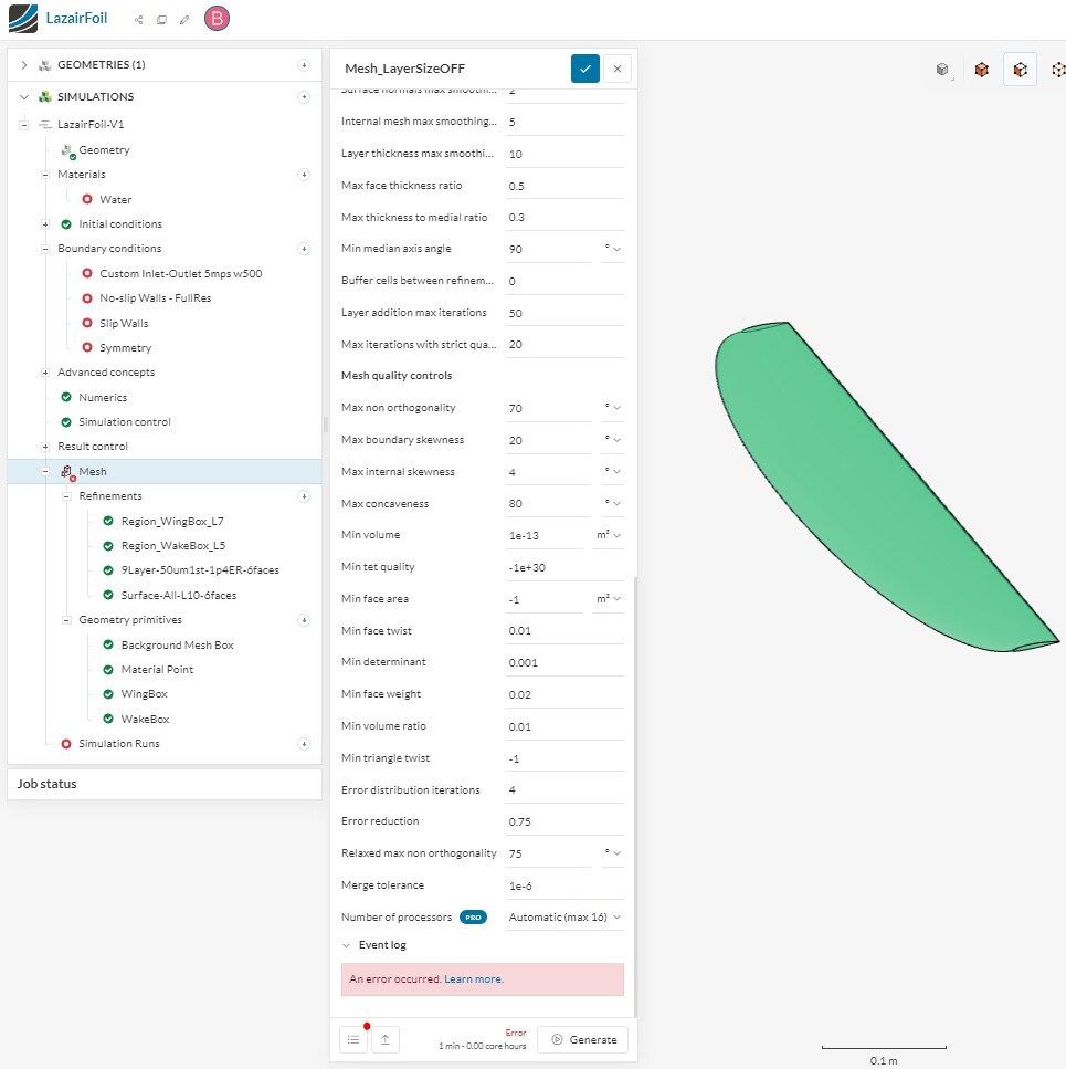

Here you go:

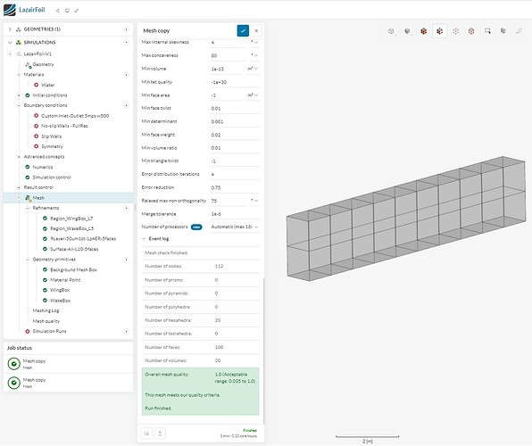

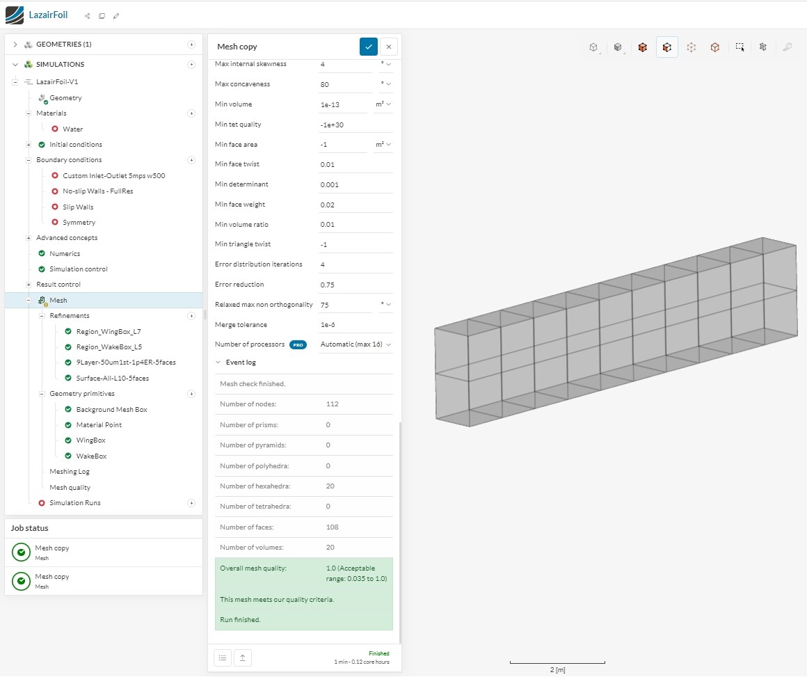

I just tried it again without changing anything but now it just makes a level 0 bounding box mesh without refining it and thereby having the geometry created in it (EDIT my first post in this topic now points to this un-refined mesh since the ‘An error occurred’ meshing attempt has been lost somehow):

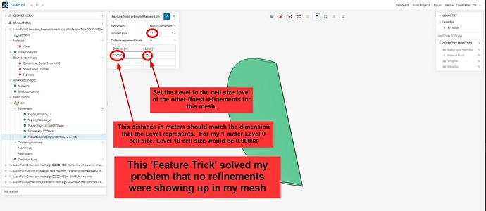

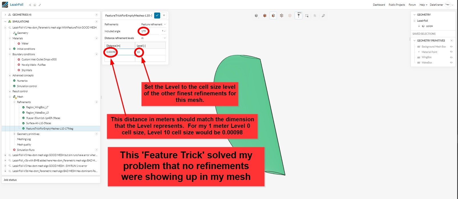

I found the solution in my own January 2020 post here: What to do if geometry does not appear in your Hex-dominant parametric algorithm mesh - try the Feature Trick
Basically, all I had to do was to use a trick that I had discovered for Hex-dominant parametric meshes and which I had coined as the ‘Feature Trick’.
The Feature Trick for Hex-dominant parametric meshes :
Add a Feature refinement to your mesh set to the max cell size level (whic his the smallest cell size in meters) of all refinements that you added to the mesh.

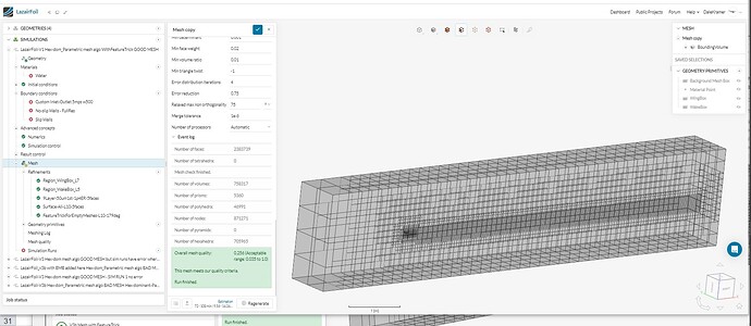

GOOD Meshing RESULT:
