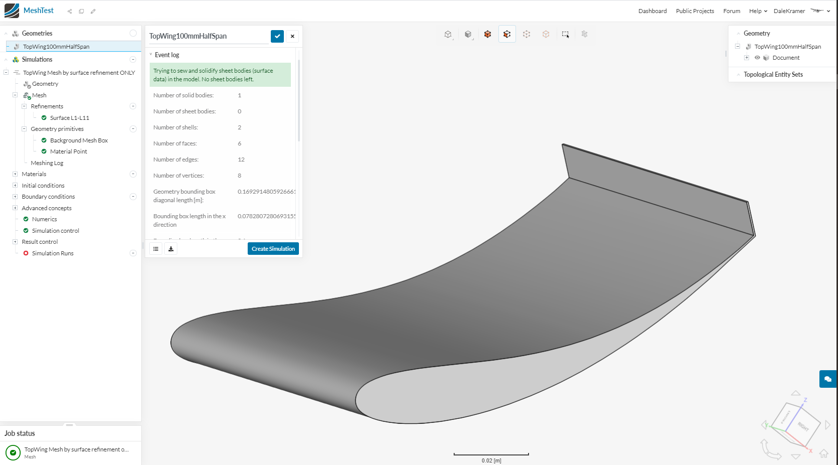

It is a very simple half wing geometry:

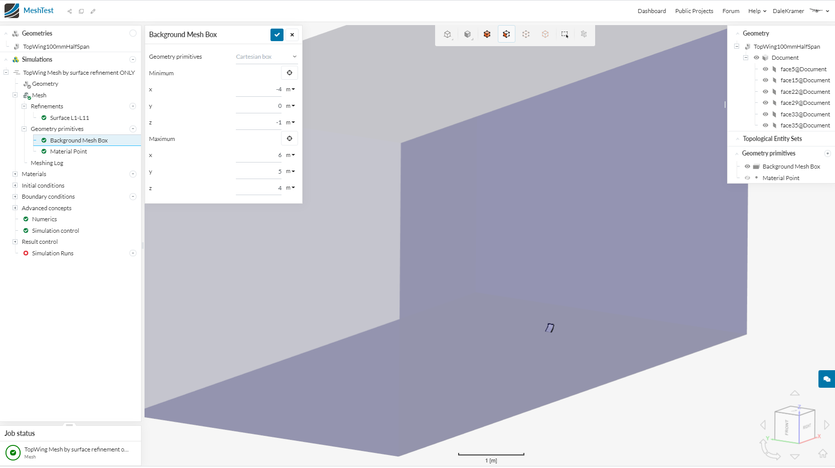

In a well sized BMB:

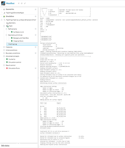

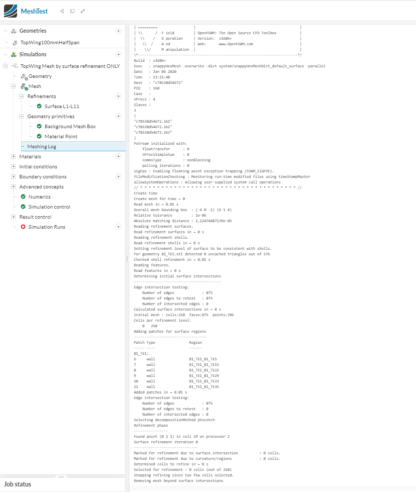

The meshing operation completes successfully, but the geometry is not meshed:
I do not see what the problem is in the meshing log, do you :question:

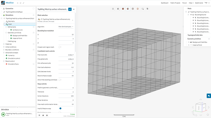

I simply increased the number of cells of the zero level bounding box mesh (“Bounding box resolution”) to make sure we have more cells to work with. I personally like to tighten the surface refinement constraints having around 1 (maximum 2 levels) of difference in the levels to give the mesh a bit more flexibility. But if you are using 1 (min) & 11 (max) you just have to increase the size of the resolution (meaning the BBox here).

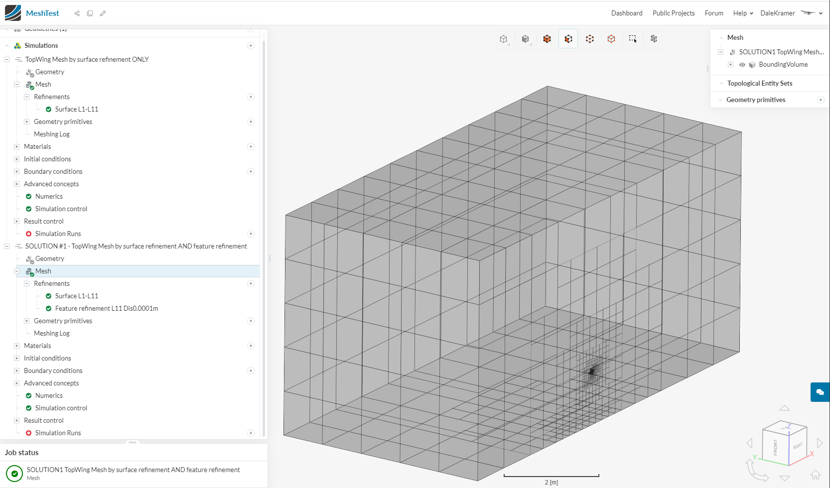

I can make this surface mesh always ‘appear’ if I simply add a feature refinement to the max level of surface refinement, I just don’t like having to do that :frowning:

i tried it without any refinement except the surface refinement. The lowest cell count i could achieve was 35x25x25.
Through the boundary box the cells have a size of 0,29x0,2x0,2 m.
I think the critical lenght in x direction is between 0,29m and 0,33m and in y,z direction 0,25m and 0,20m.

The Feature Trick even fixed an empty mesh that nobody could figure out why it remained empty and here
Here is that empty mesh result:
Here is the mesh when a Feature refinement was added at the most refined level of the other mesh refinements:
