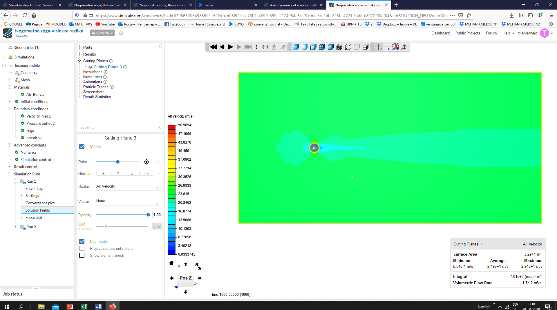

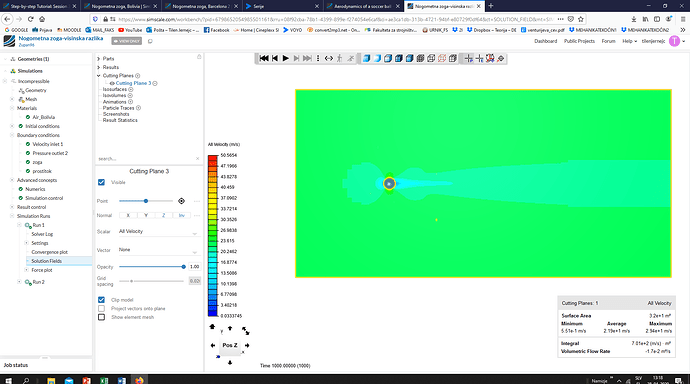

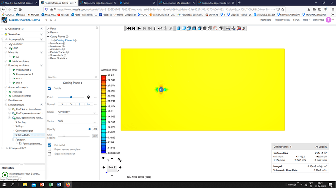

I’ve checked results from someone who did this simulation a while ago and there are some differences in forces and solution field is not quit the same, so I’m not sure if I got the right results. I’m interested in flow behavior and not so much on a Magnus effect.
This is how it should be I suppose:
This is how i get it:

Hi: You got the flow in different direction…
Please check cutting plane and direction of the flow when visualizing it. I have not seen your project: I only use two screen shots you attached.

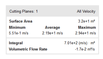

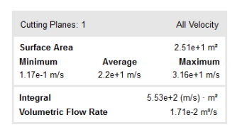

You have that info on the first visualization:
On the second one you have different one:
You may notice, that Volumetric Flow Rate is negative in first case and positive in second. Magnitude is the same. Please try to answer why.
