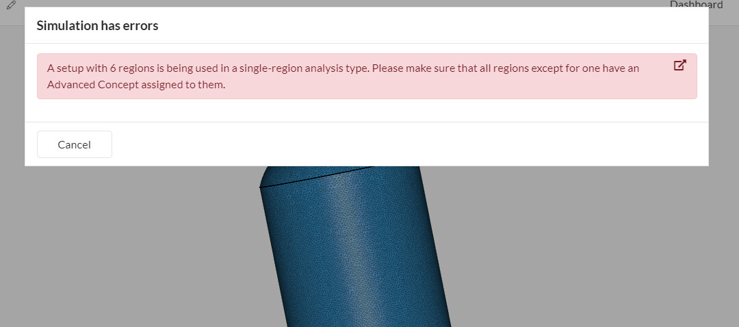

When I want to perform the simulation, an alarm appears that does not leave me and I get this alarm:
A setup with 6 regions is being used in a single-region analysis type. Please make sure that all regions except for one have an Advanced Concept assigned to them.

I had this problem - when deleting all the geometric objects except the flowfield, i was able to do the simulation.

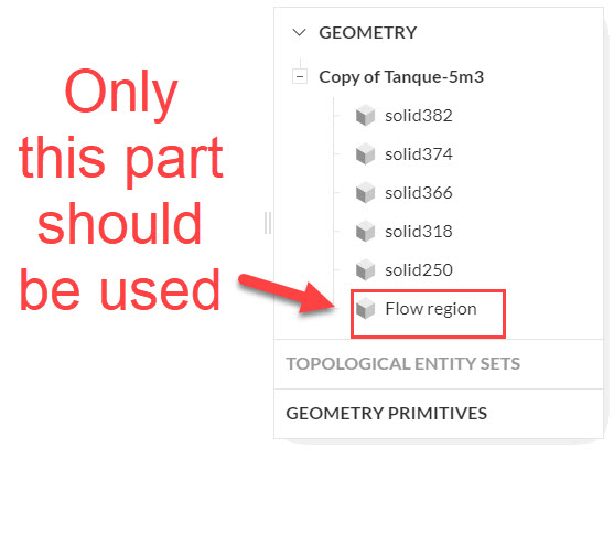

for an incompressible analysis, only the flow region should be used.:
Please delete the rest of the parts in CAD mode using the Delete body feature.
