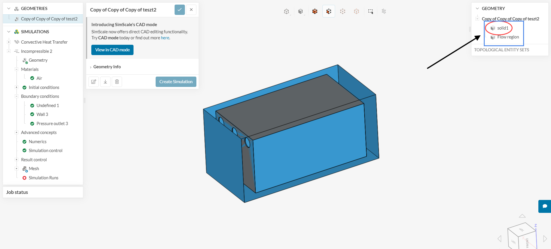

"A setup regions is being used in a single-region analysis type"
So, I always get this massage.
“A setup regions is being used in a single-region analyses typer. Please make sure that all regions except for one have an advanced concept assigned to them.”

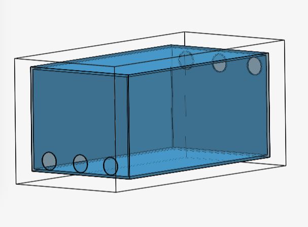

Briefly about the project. I want to blow air through a closed chest using a fan.

I want a simple thing as a first step. The air passes from side to side. Then I make the electronic components that go into it. I don’t want to use the fan setting with only air inlet, because if it’s good then I’m looking for a fan for it.

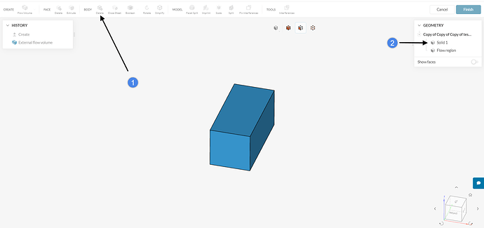

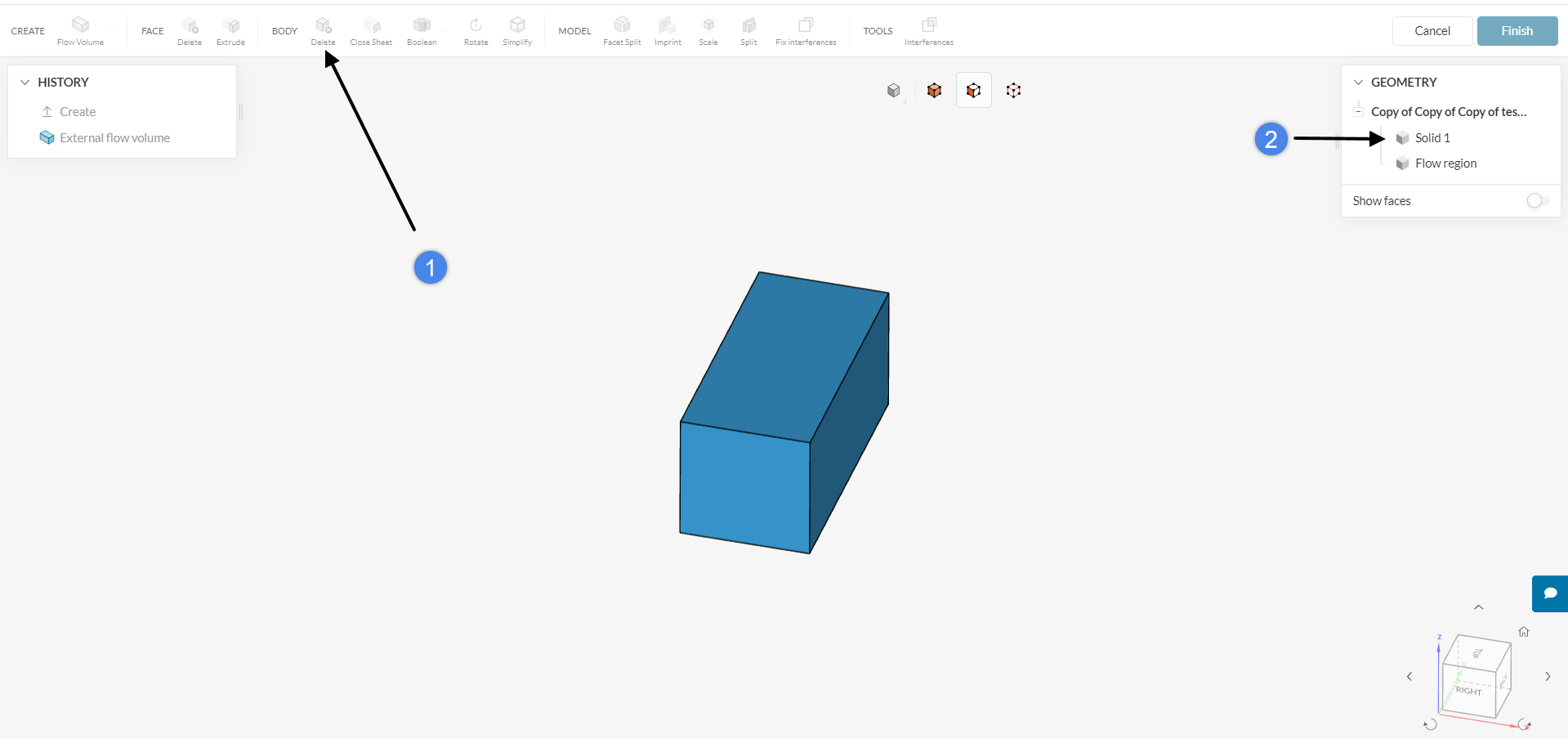

The issue here is simple: under normal circumstances for incompressible analyses, we need a single volume, representing the flow region, to run the simulation. If your CAD model has more than 1 volume, you will run into multi-region errors down the line.
The flow region, as I mentioned, is what we want. Solid1 is the part causing issues. The remedy here is very simple: head back to CAD mode, create a delete body operation and delete solid1.
The resulting model should be good to go.
