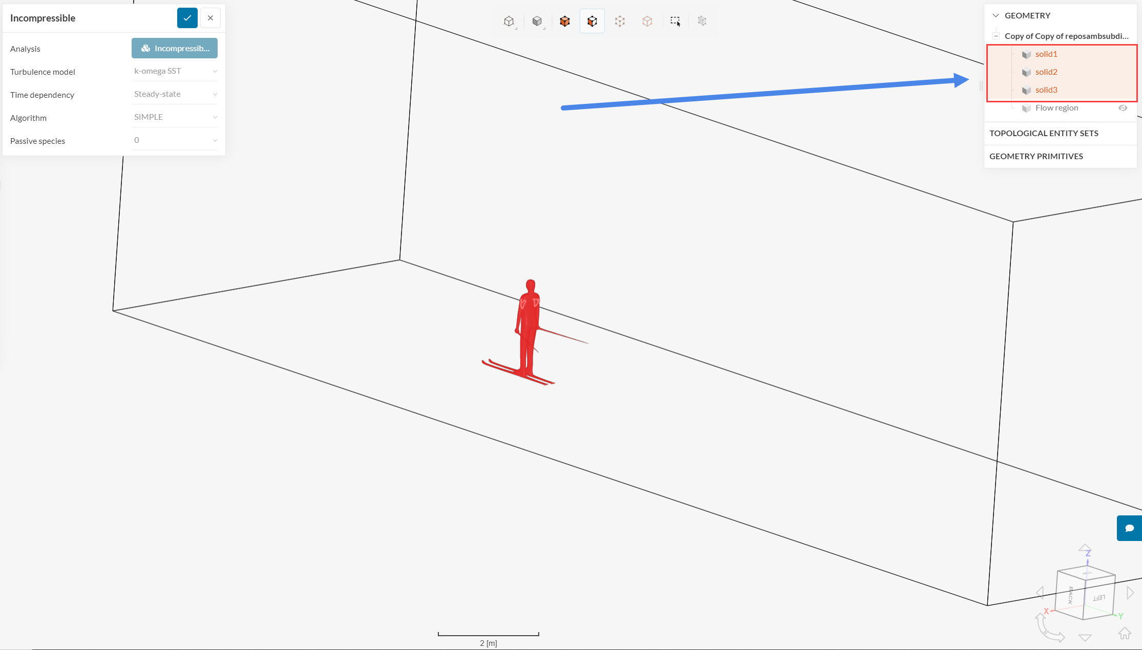

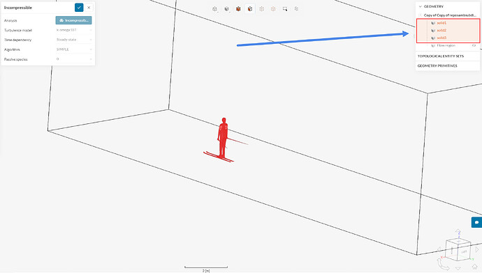

Hi there, for an incompressible analysis, only the flow domain should be present, meaning these 3 solid parts should be deleted:
You can do this by using the CAD mode, and specifically the Delete body feature.
Regarding the second question, do you have a specific project you are referring to? The one you sent me does not seem to contain any Advanced concepts.
Ok, I’ll try to delete them, thanks. But what do you mean by 2nd queston?
Is this another concern of yours regarding your project?

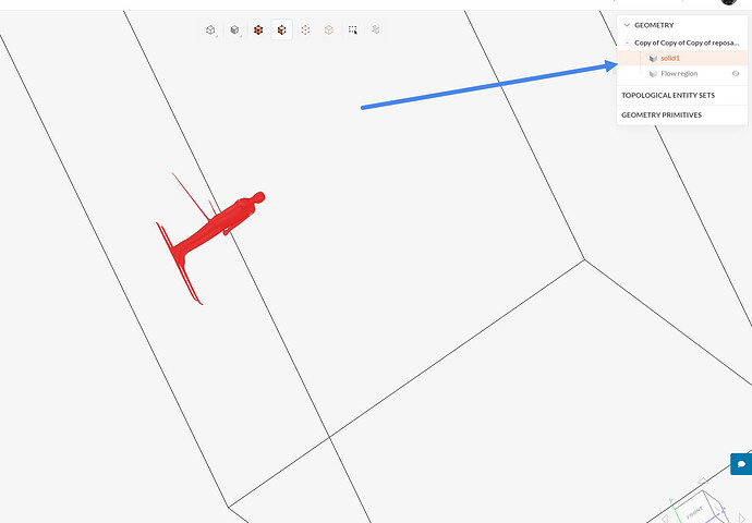

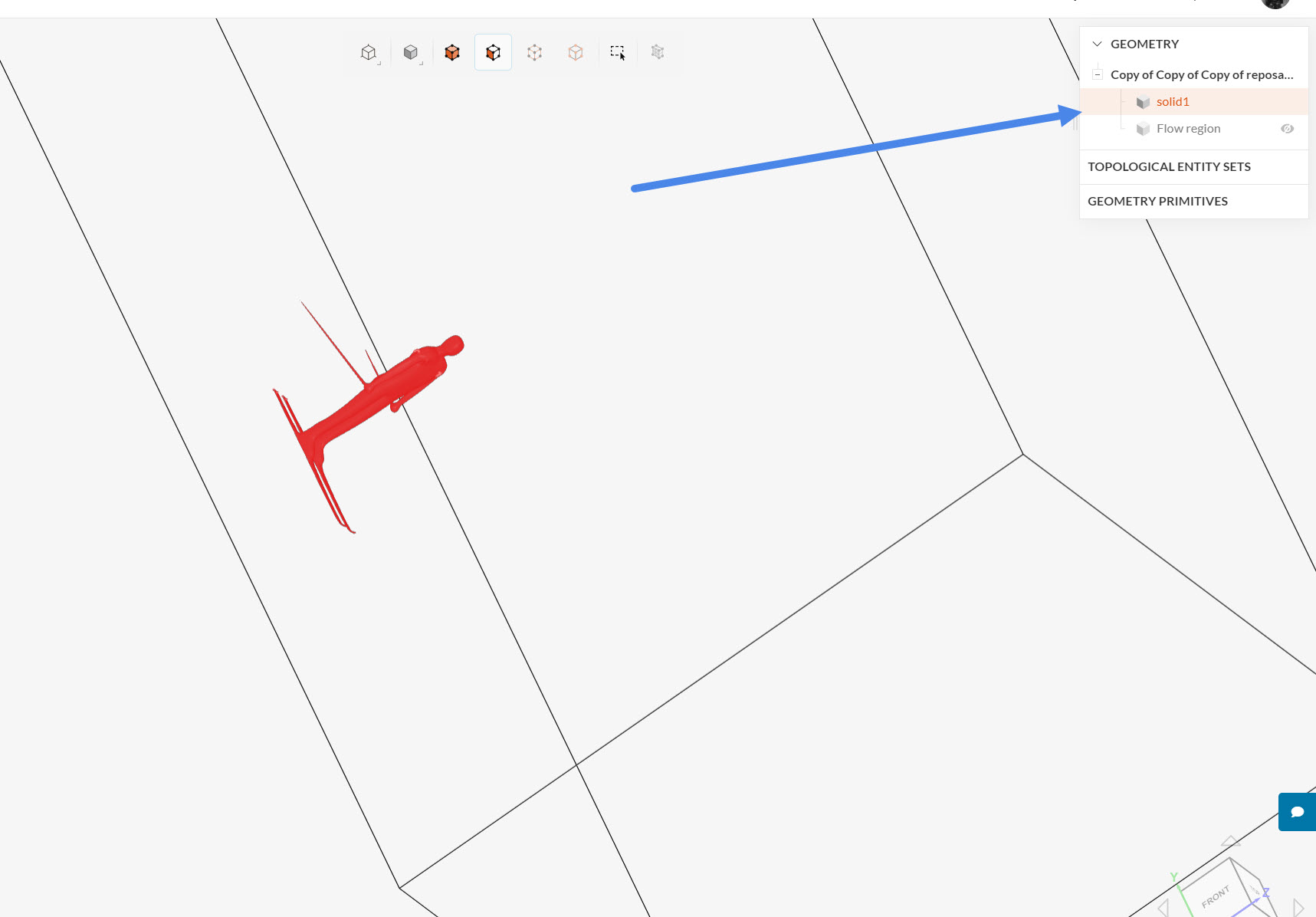

Well, now that I’ve generated my mesh I decided to run the simulation, but this appeared again: "A multi-region mesh was assigned - this analysis-type requires a single-region mesh. "
It makes sense, because the solid part is not removed yet:
But then it would delete the 3D model, right?
Sure, but the gap inside the domain that represents the model will still be there :slight_smile:
