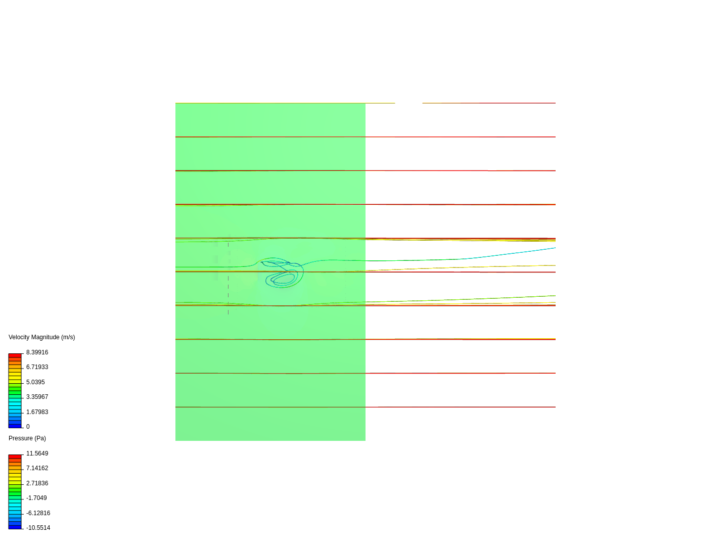

Im not sure if anyone is able to help me on this. I am currently a masters student doing my thesis on bench-marking open-source or low cost CFD packages. I am currently benchmarking this case below
It is taken from the validation cases. However I am changing the inlet to allow for a table of values for K that are taken from the following spreadsheet
https://www.aij.or.jp/jpn/publish/cfdguide/data/CaseB(4_4_1).xls
I am doing this as I need ot be as accurate as possible for my thesis and the validation case used a set fixed value for K to simplify things.
My only issue is that I am unable to run this due to memory limitations, if anyone has the resources or time I would HUGELY appreciate someone running Run 3K in this project. I cant reduce the mesh size as I have been consist with the mesh fineness throughout the other packages.

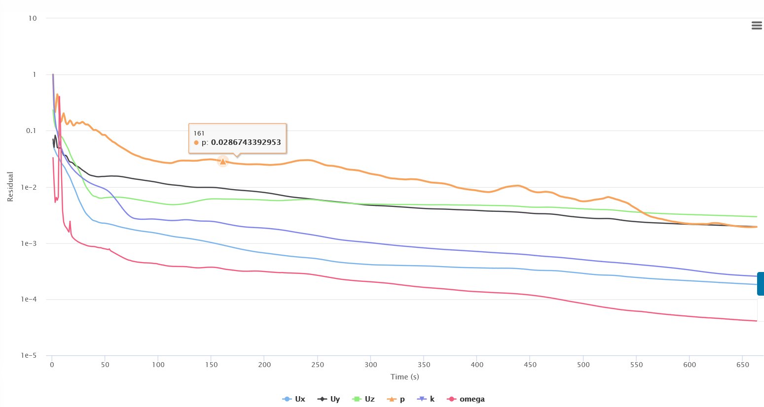

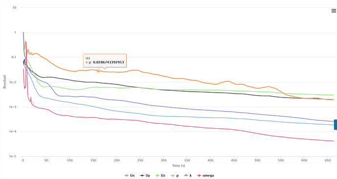

quick update, it takes a bit longer than I thought, so far the residuals
unfortunately it will save the first set of results at 1000, so gotta wait a little longer, what results are you aiming for? You could check if the results at 1000 are accurate enough yet.
Wow are an absolute legend! Ive run a the other packages to 2000 iterations but there was an insignificant difference between the results at 1000 and 2000 iterations and from what I seen K is below 1e-3 which is where I was for the others which is perfect.

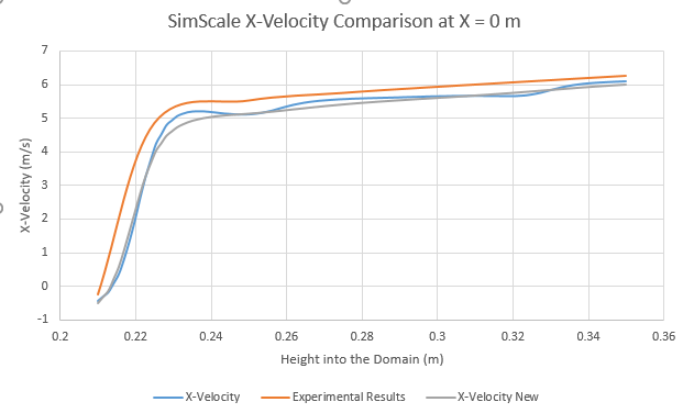

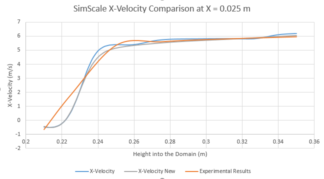

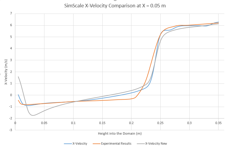

Hi Guys just thought I would quickly share my findings roughly. Using the different K values definitely Made a significant impact. The graphs are velocity profiles at different x positions, he first two are from the top of the building to the top of the domain and the last is from the floor to the top of the domain just behind the building.
I just want to says thanks again! As you have hugely helped my work and will be in my acknowledgments page of my thesis.
