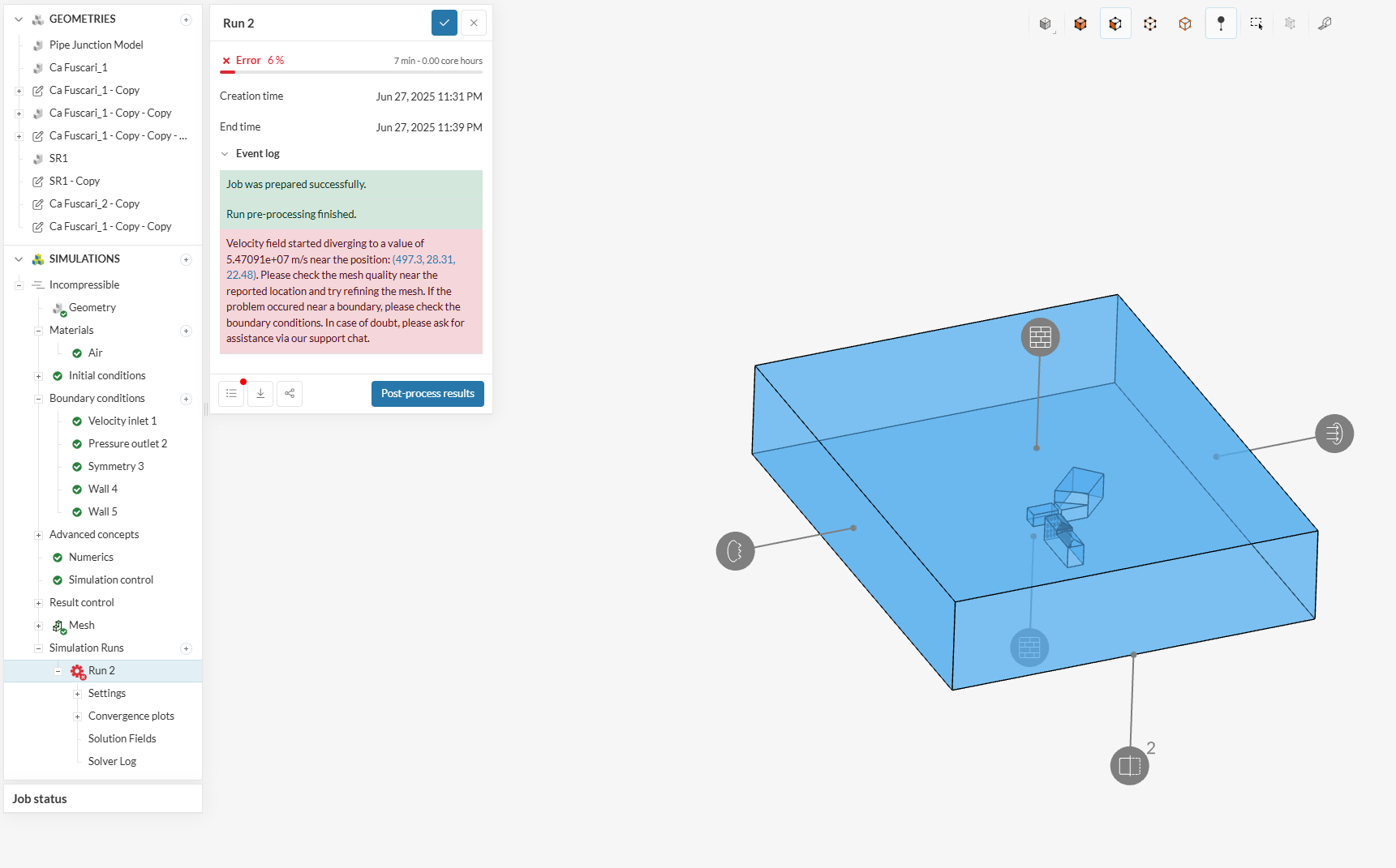

When running the wind flow analysis, I receive an error regarding the mesh of the model. Could you please help me solve this issue?
Thank you.
Thank you.

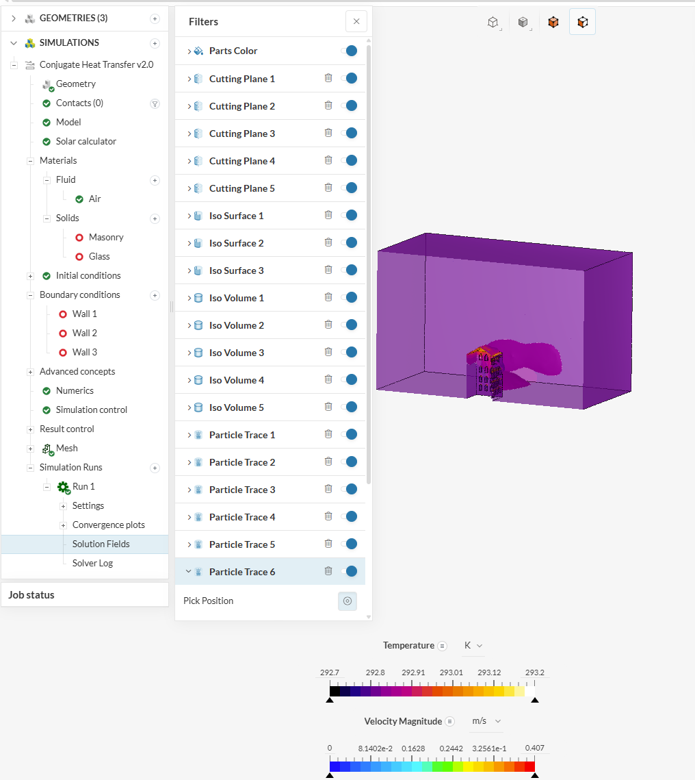

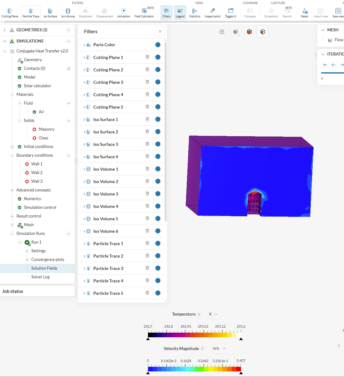

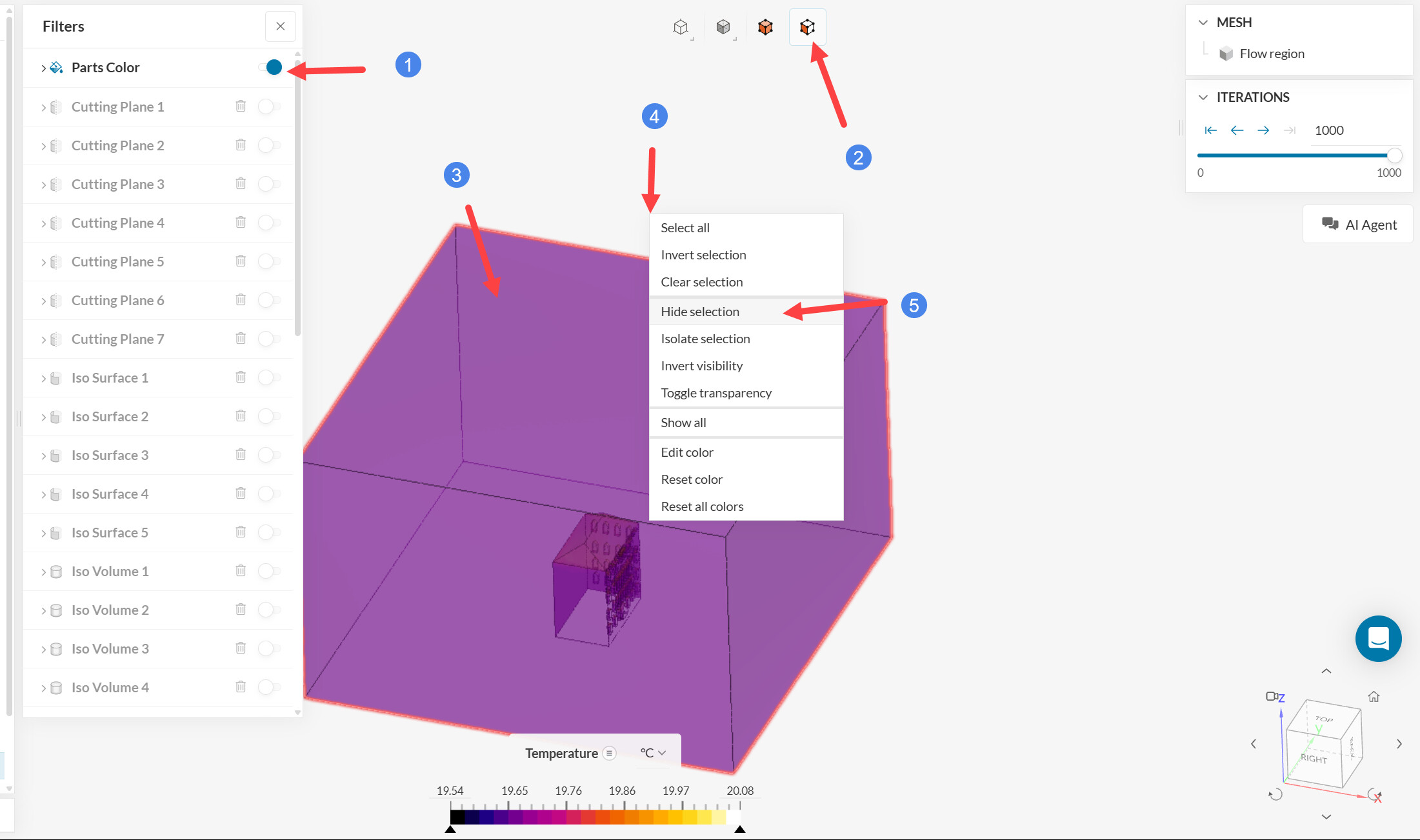

I am running Conjugate Heat Transfer v2.0. The results show the temperature in the hollow part of the building. I need to see the impacts of the solar radiation and temperature on the north and east walls (walls with openings). Could you please let me know how I can have these results on the walls?
Thank you.
Hi!

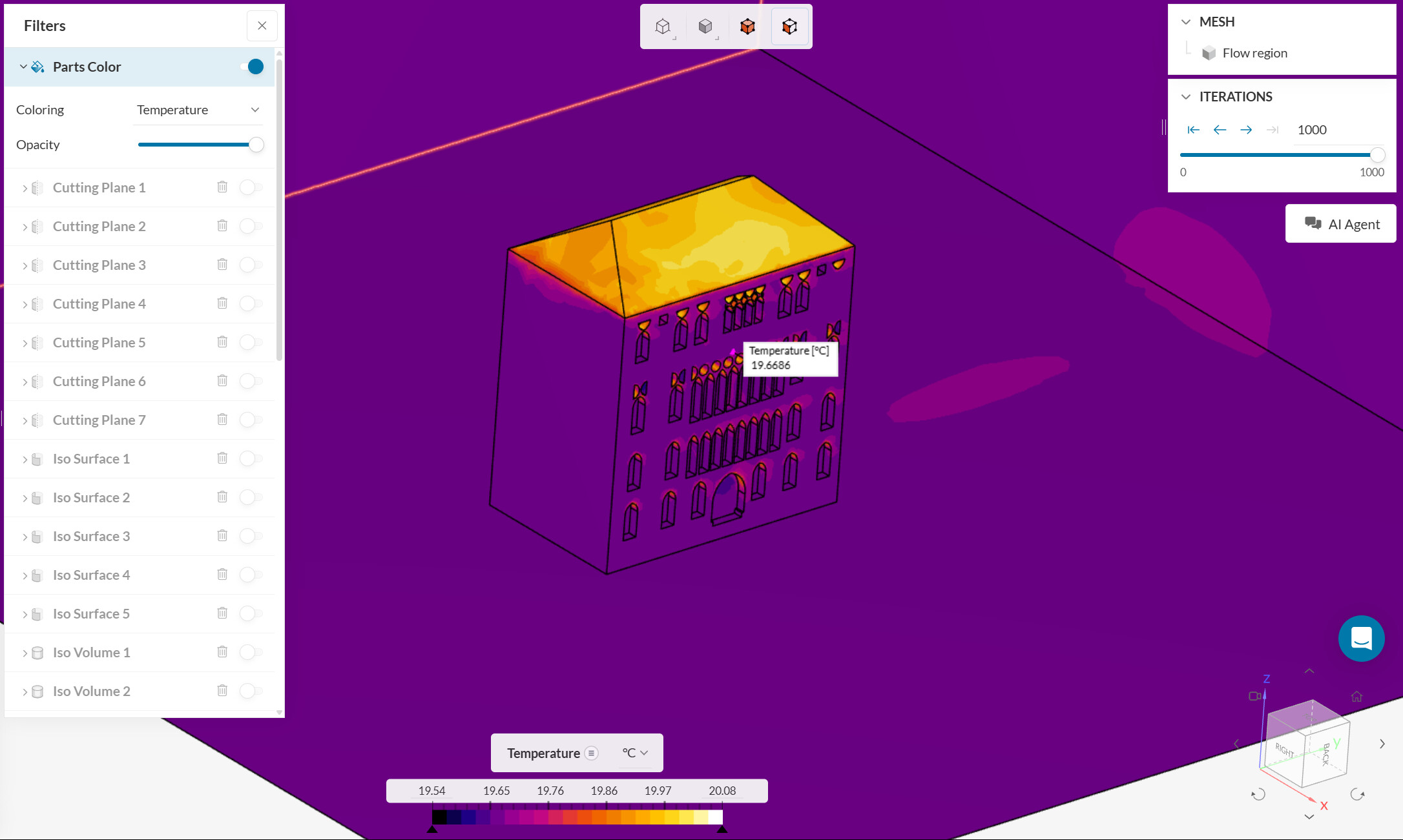

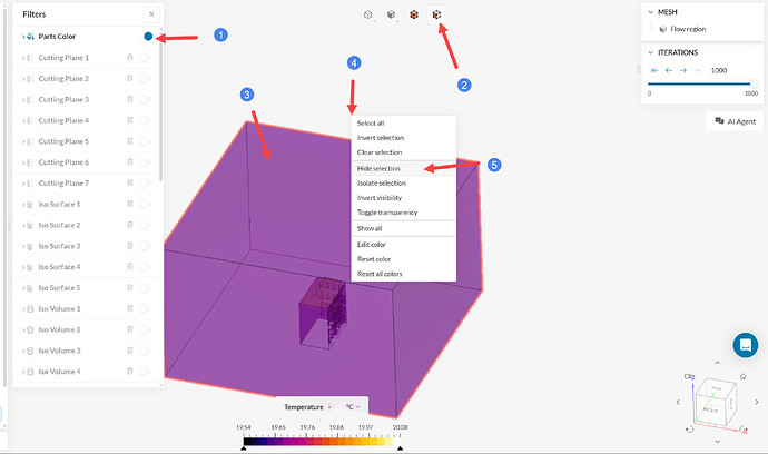

To access the building walls, you would normally follow the steps below:
This hides the external faces and let’s you see and interact with the building faces. E.g. you can use inspect point, statistics, etc.
