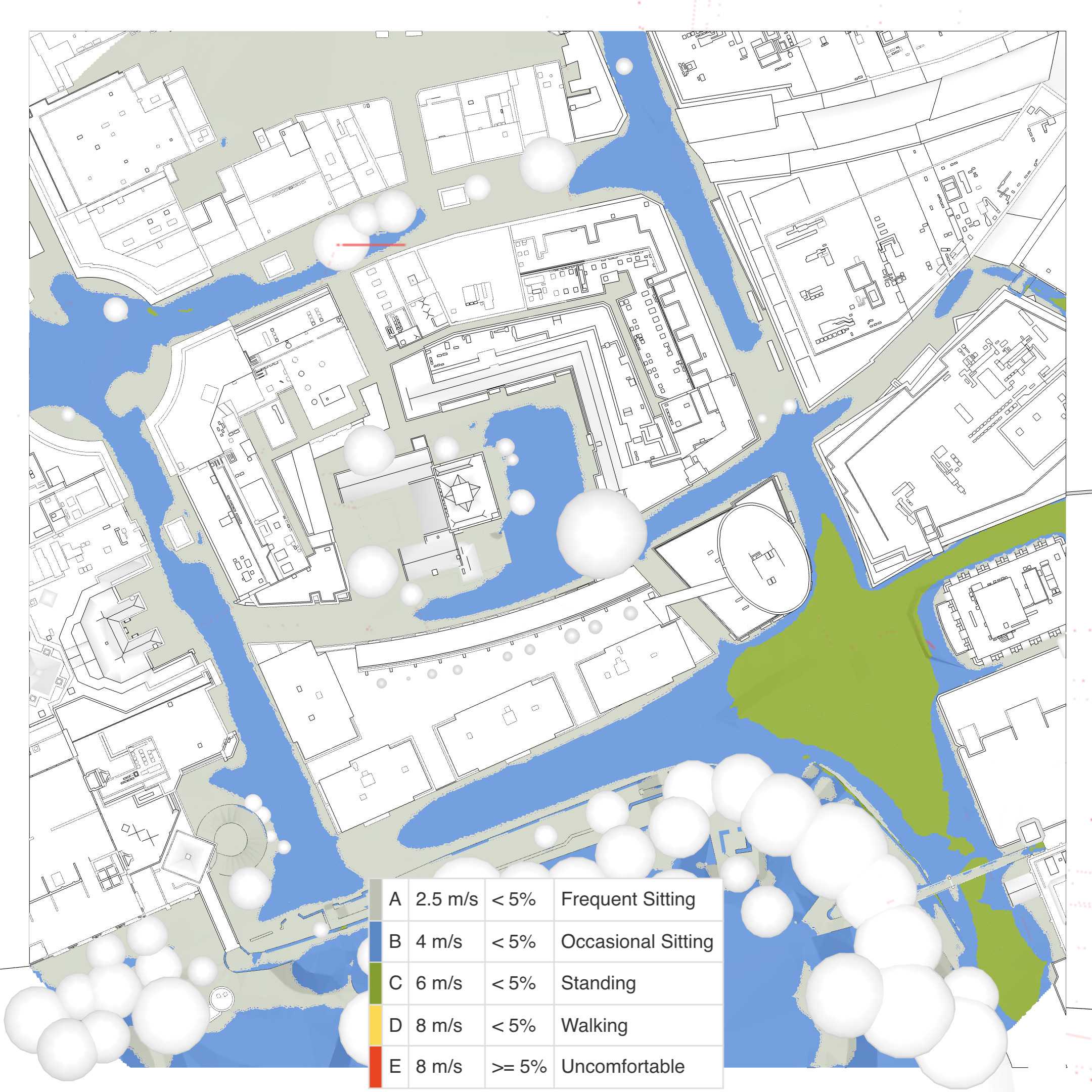

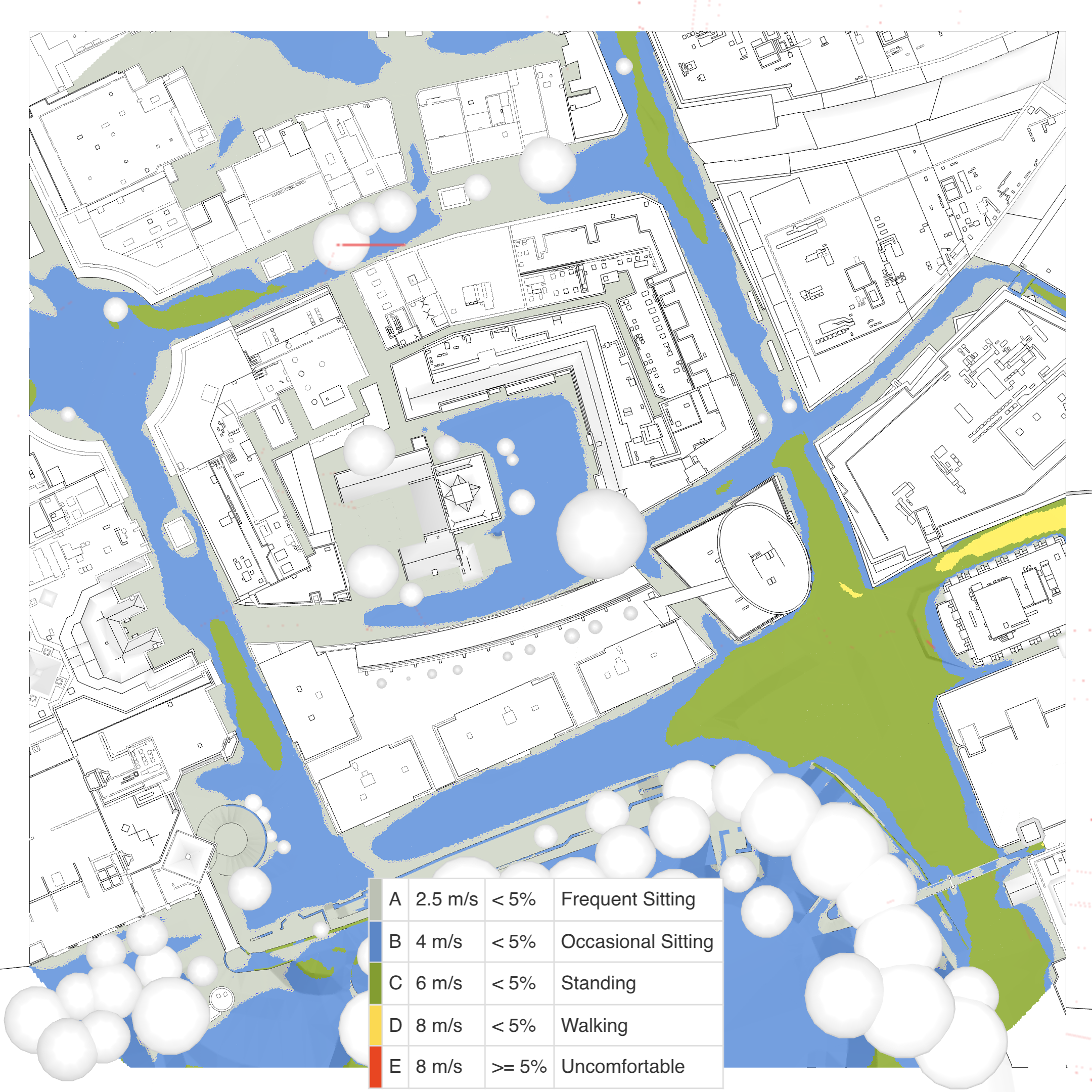

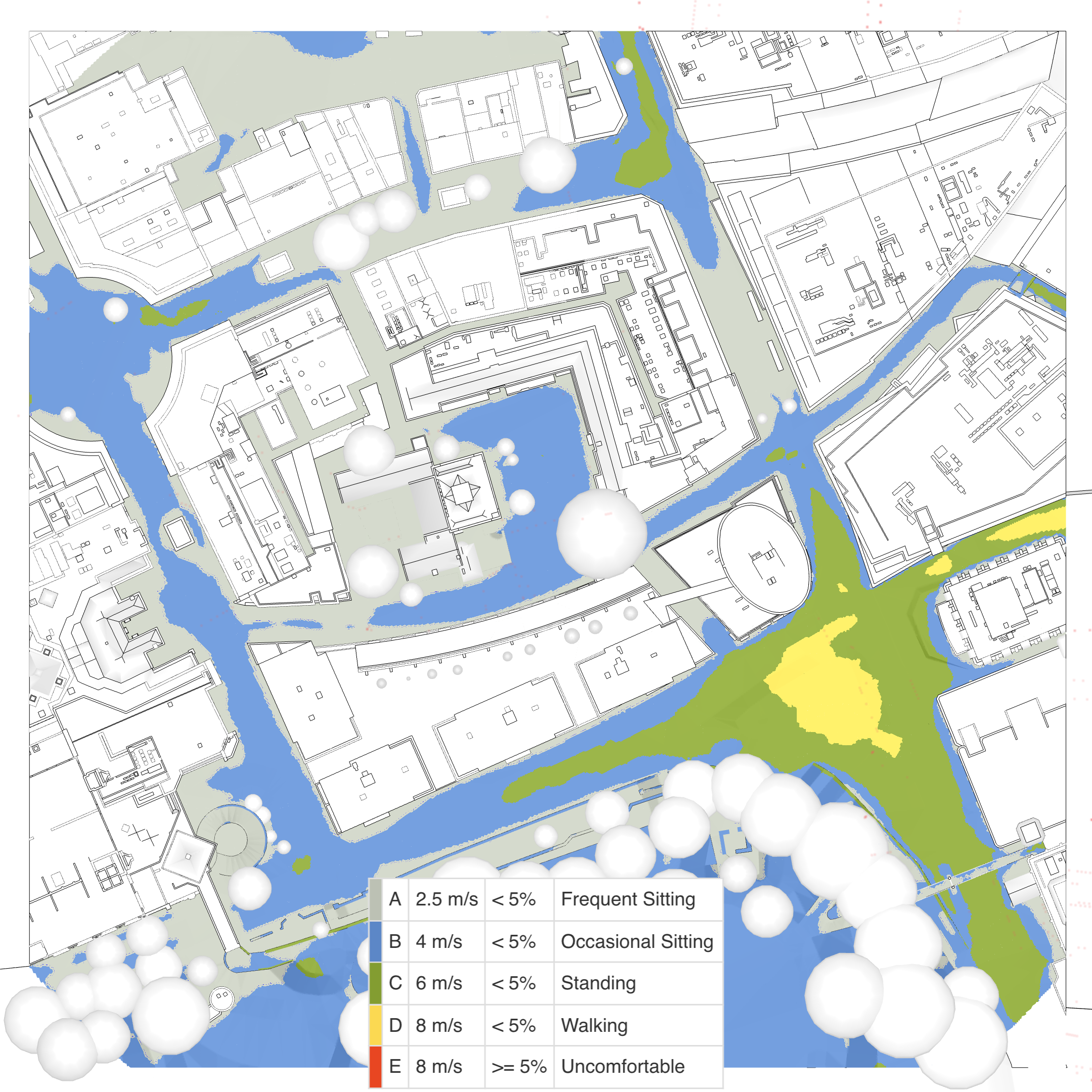

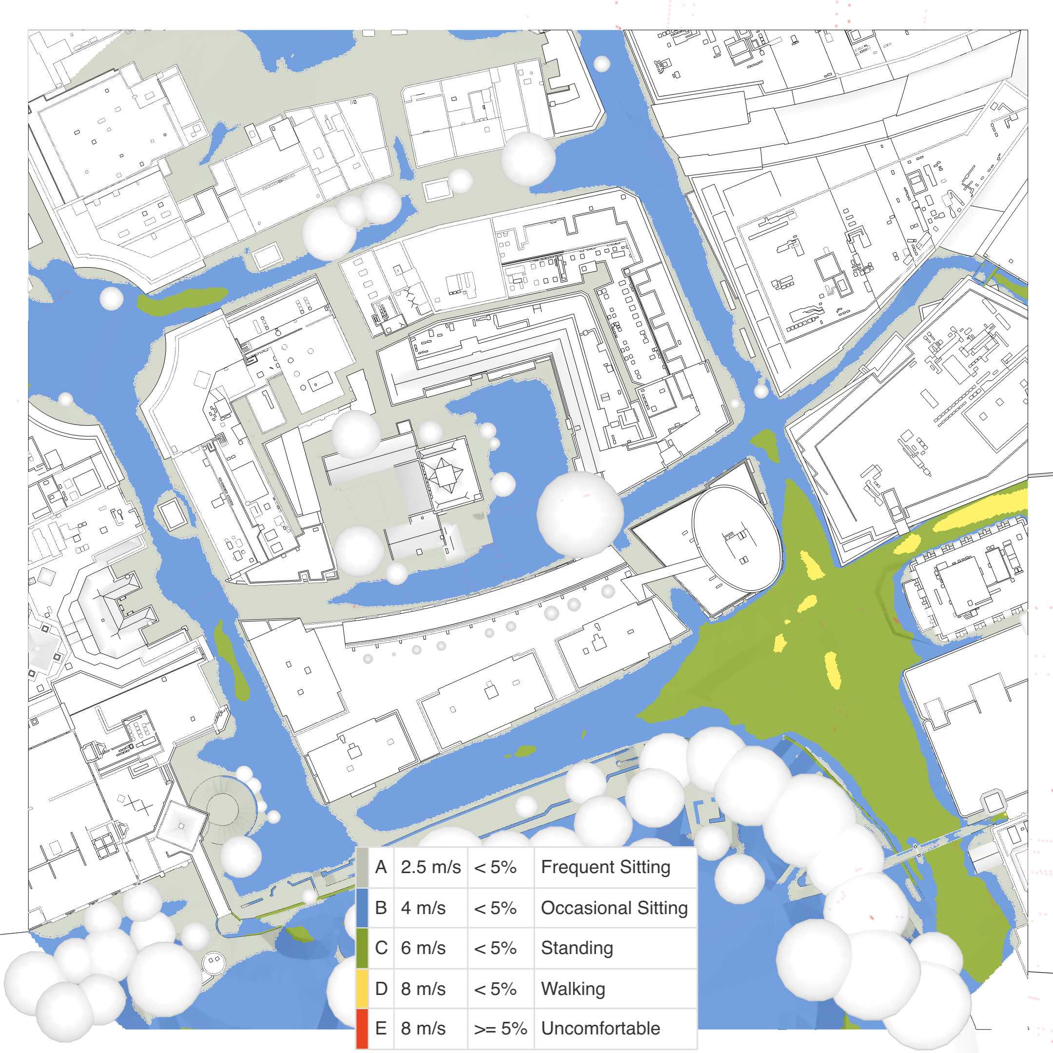

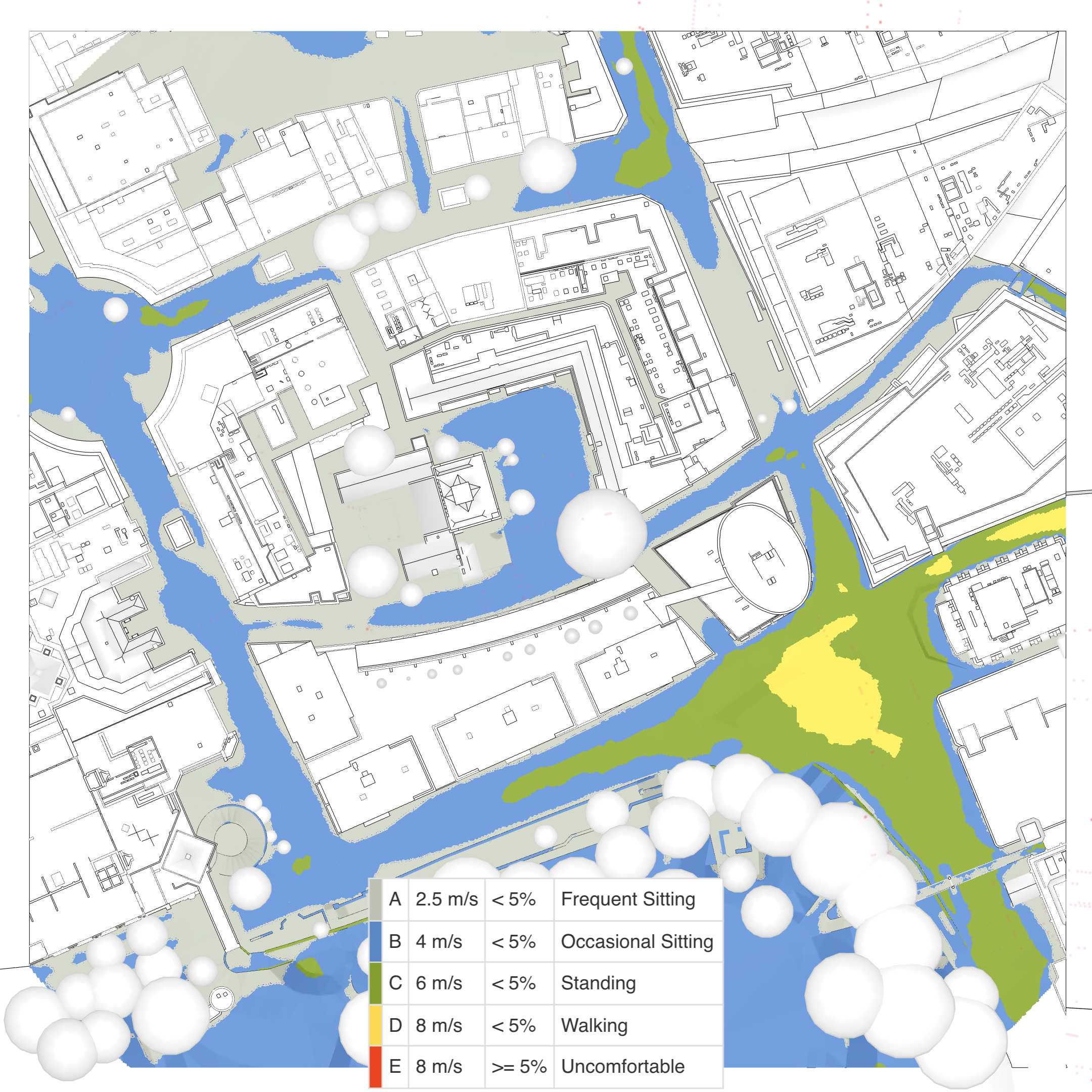

We have long known that users will see little difference until a full 36 wind direction study is performed, and a user should not be surprised to see little difference if running fewer directions. To make this more commonly known, we have produced the below example.
Summer
Left: 36 Wind Directions, Middle: 16 Wind Directions, 8 Wind Directions
Winter
From the above visualisation, we can see firstly that increasing the number of directions does change results to a degree. But more importantly, comparing Winter to Summer, there is only a significant difference for the left-hand images, 36 Wind Directions. A keen eye will see differences for all. However, it is much less obvious.
