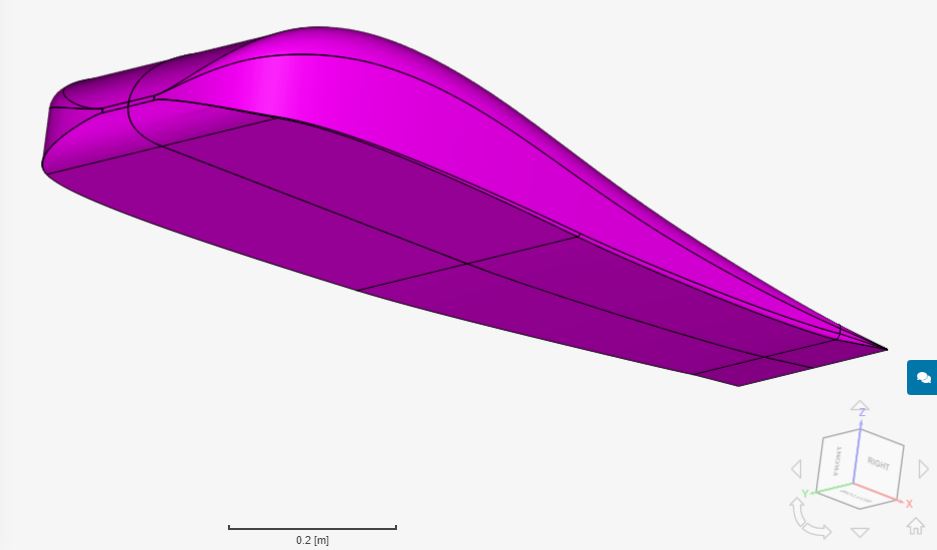

Can anyone help me understand why this 1 meter long streamlined body:
seems to have 0 pressure drag (X-direction) at ~34 meters/sec?

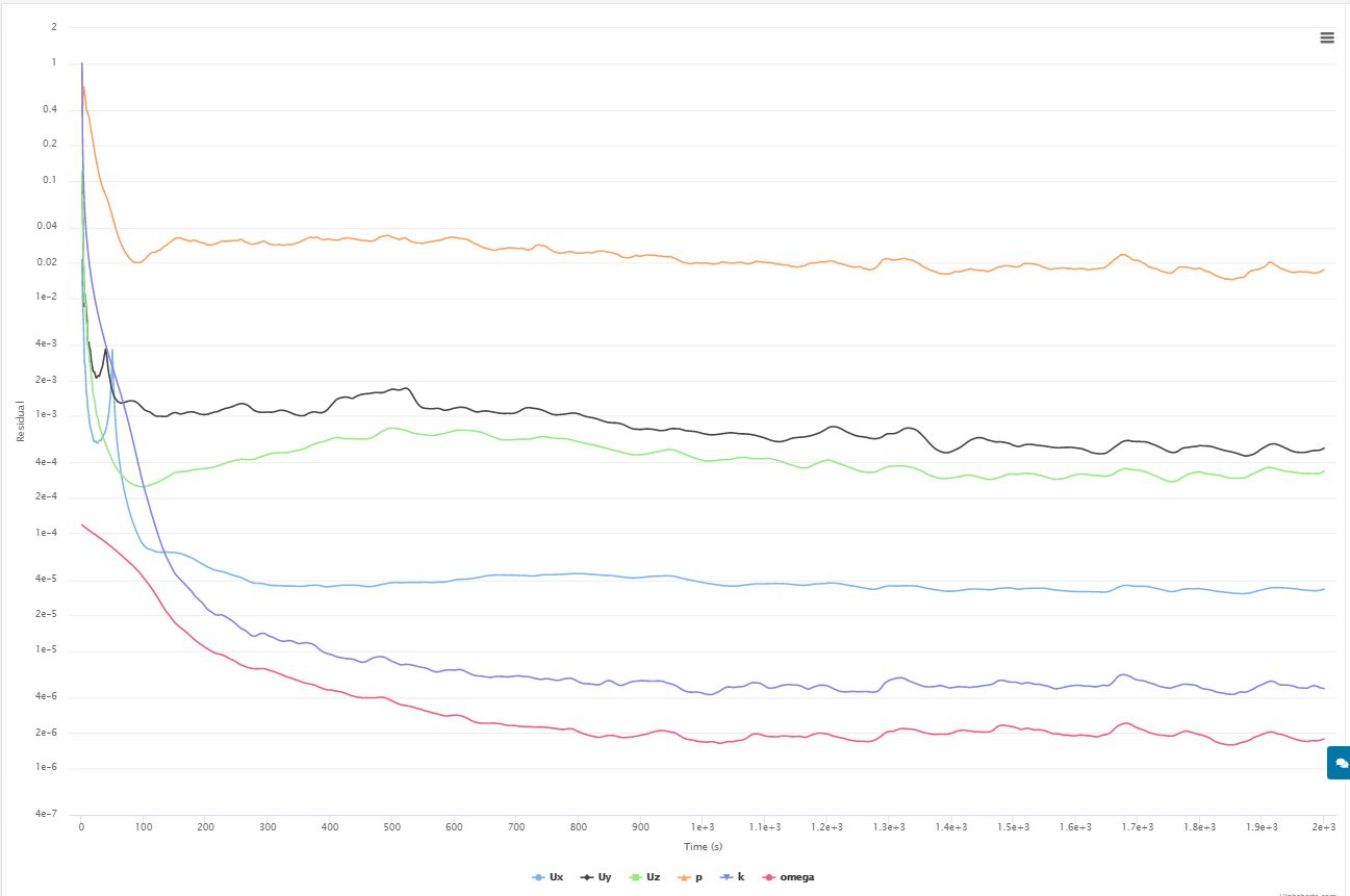

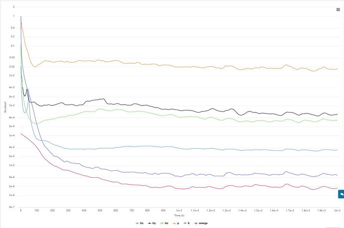

Here is the convergence plot:

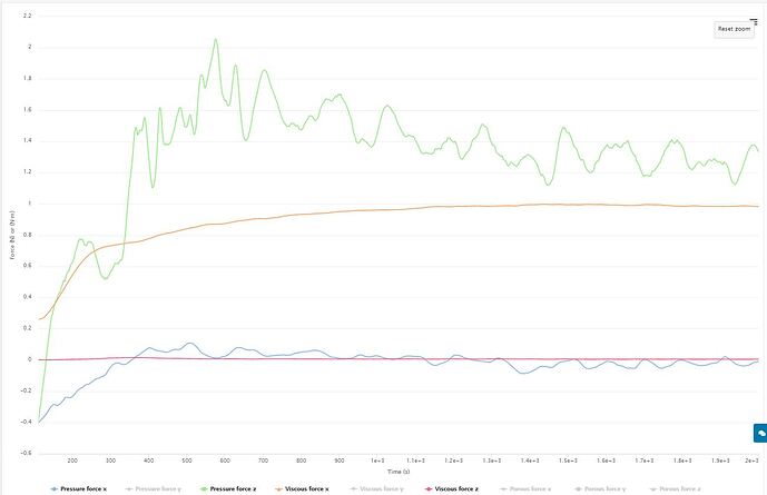

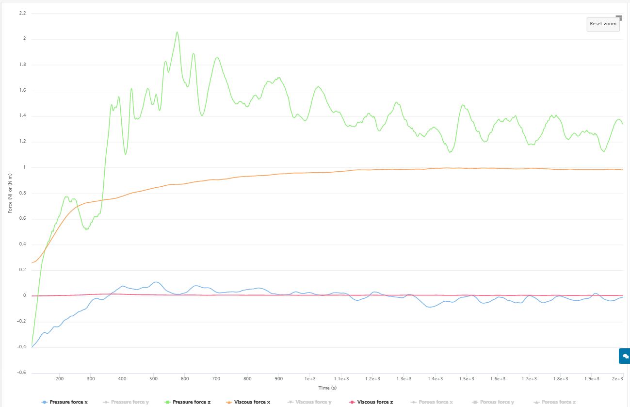

Here is the force plot of the right half of the left/right symmetrical body which shows the strange 0 value of pressure force X (pressure drag).:
Also, we can see that my project predicts that Pressure ForceX and Viscous ForceX add up to only ~1N
But if we do a napkin calculation assuming a Drag Coefficient of 0.1 (just an educated ballpark number
) for this body we might expect to see 2.5N of drag.
I think I have applied good principles in meshing and simulation parameters, have I missed something?
