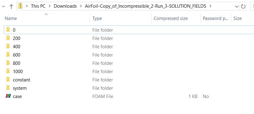

Hi, I attempted to download two different result sets from your project and it seems to be working as intended.
Feel free to post screenshots if that’s not the case.
PS: the case.foam file is just a blank file with a .foam extension. You can create one by saving a blank notepad file with a .foam extension.
None of these other folders are with the files downloaded. PS, I’m using a Mac!!
The .foam file is a dummy file which is created by Paraview: Case Name .foam File - OpenFOAMWiki
I advice you to test the download using another computer / updated browser…
