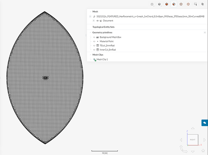

What to do if geometry does not appear in your Hex-dominant parametric algorithm mesh - try the Feature Trick
This issue is much broader than I first imagined…

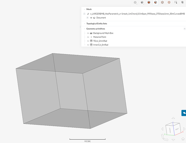

The Feature Trick even fixed an empty mesh that nobody could figure out why it remained empty and here
Here is that empty mesh result:

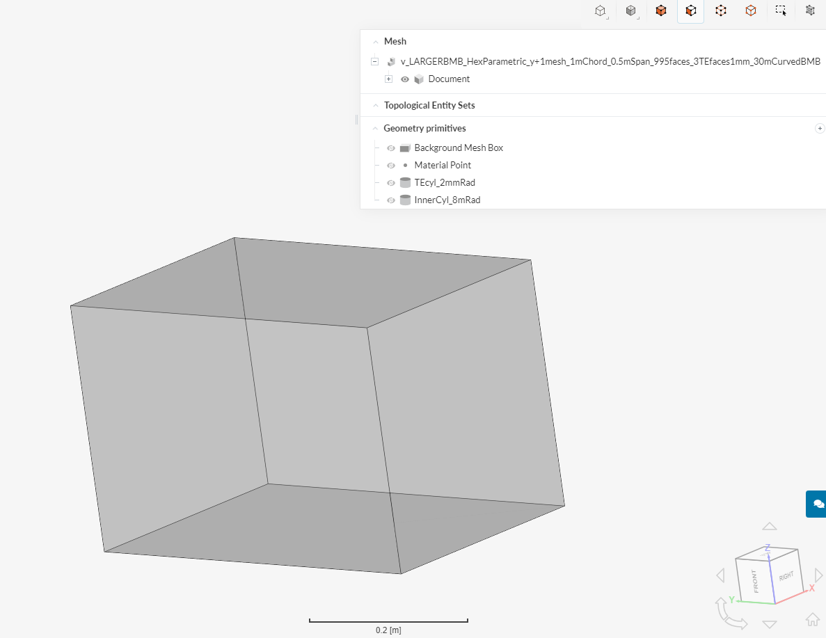

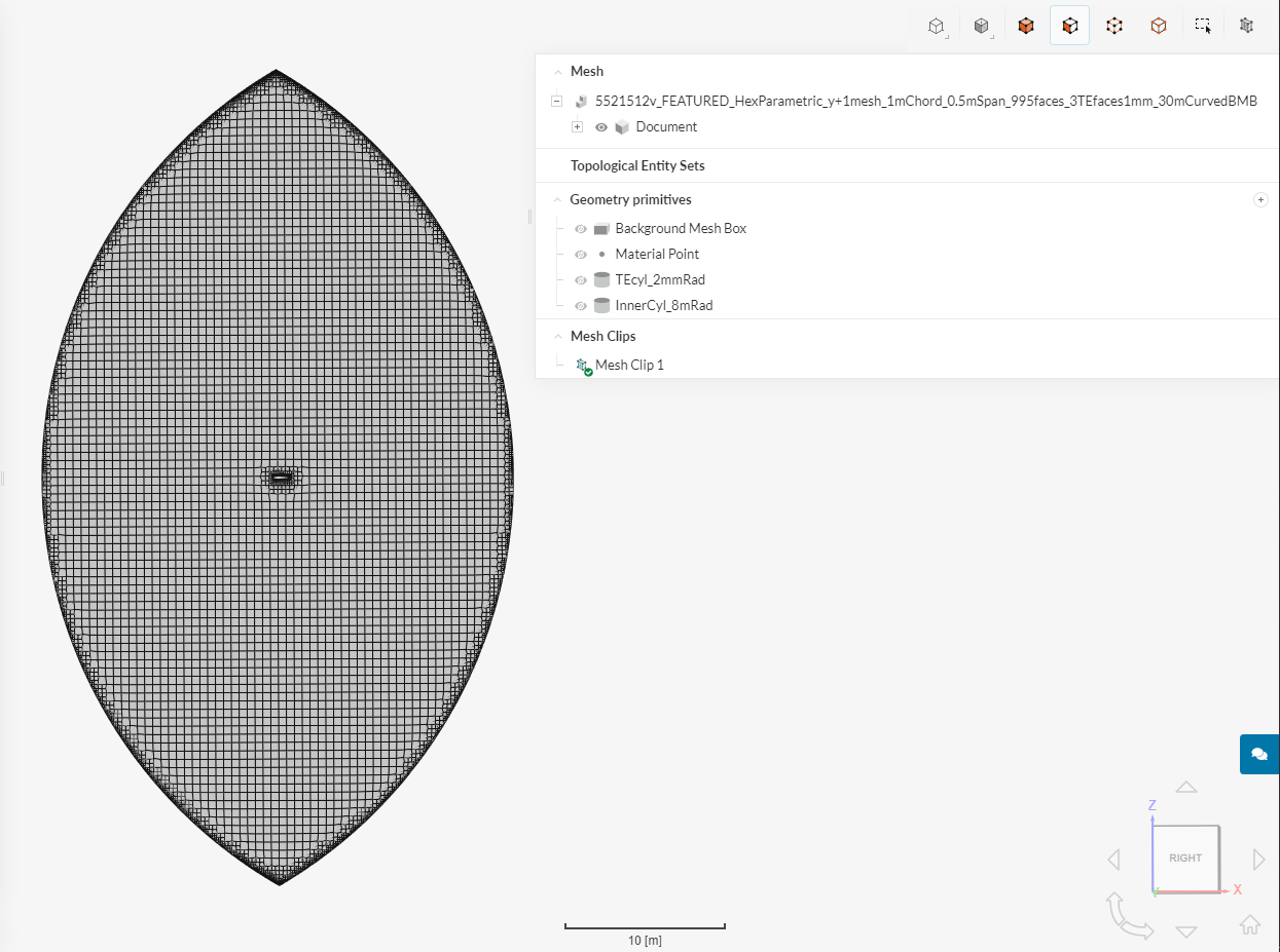

Here is the mesh when a Feature refinement was added at the most refined level of the other mesh refinements:
So, when you have an empty mesh, give the Feature Trick a try :wink:
