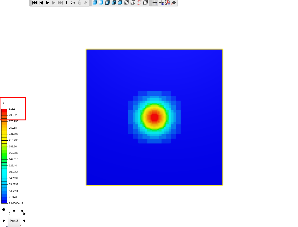

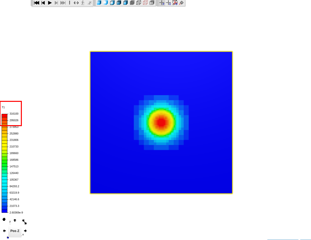

It is important to understand the correct interpretation of units used for passive scalar sources. Since passive scalars do not affect the dynamics of fluid flow, units for passive scalars are independent to the unit system of simulation. Thus one can define a passive scalar flux as 100 1/s and interpret it as a flux of 100 g/s or 100 kg/s as per one’s convenience. However, these interpreted units must be kept consistent throughout the simulation setup (for values specified in initial conditions, boundary conditions etc). Scale of the results will directly correspond to absolute value of input variables.Below you can see comparison between cases for two different passive scalar source values, one defined as 500 1/s (interpreted in grams) while other as 0.5 1/s (interpreted in kilograms). We see that the final results are only scaled by the equivalent factor (1000 here, see legends), whereas the actual dynamics remain unaltered. Thus the relative distribution of passive scalar remains the same. This is evident from following figure
Passive scalar distribution for flux = 500/s
Passive scalar distribution for flux = 0.5/s
