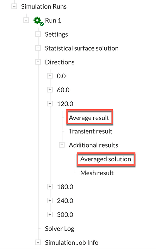

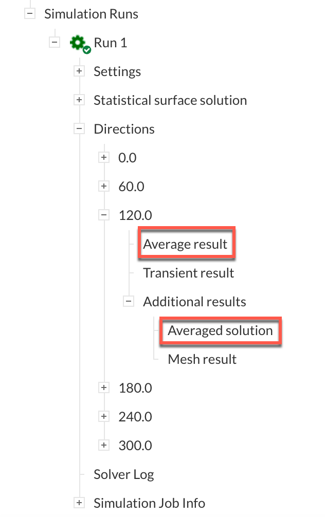

After a PWC simulation is finished, the results tree under each Direction contains two fields that could potentially be mixed up, the “Averaged Solution” and the “Average Result”:

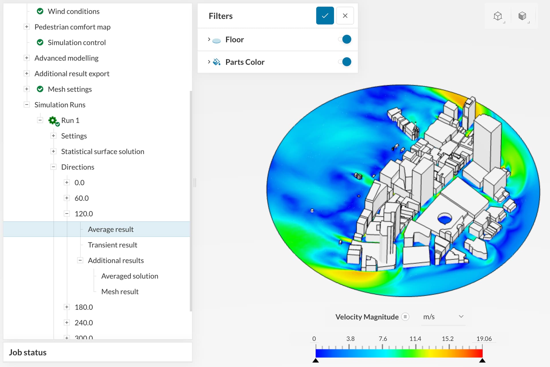

The Averaged and Transient Result shows the result only on the pedestrian level. This output is the one that is used to calculate the comfort result.
The “Averaged solution” is the Additional result control item where we can have the Cartesian box or local slices. There you can create the cutting planes, streamlines, etc
