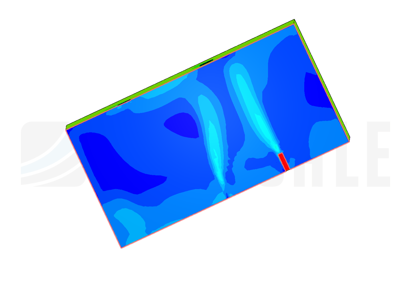

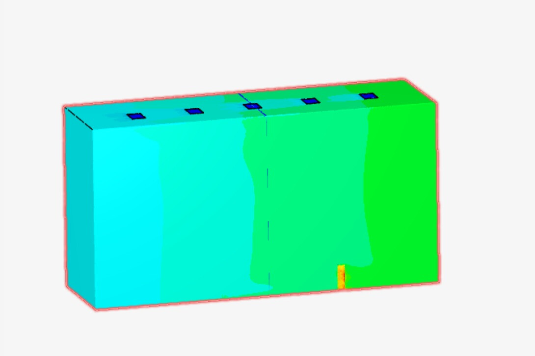

What if I want to know energy dissipation to a specific boundary
I have run a simulation about the sealed domain region heat-transform issue…
Yet i have the result from it as the figure shows
I want to know if simscale provide a function to calculate a specific part (pannels on ceiling) of boundary 's energy absorbtion.
