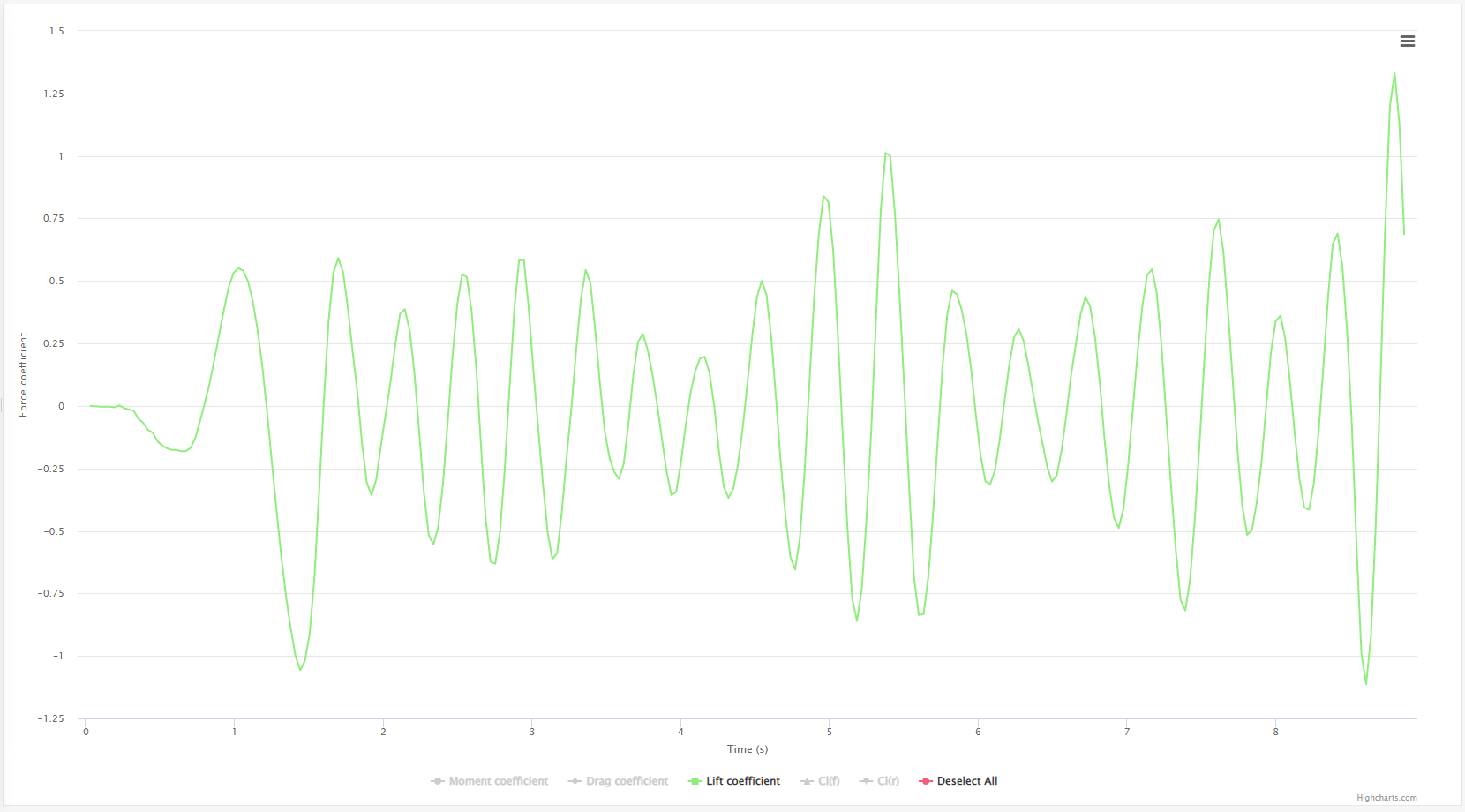

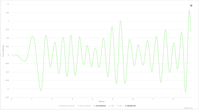

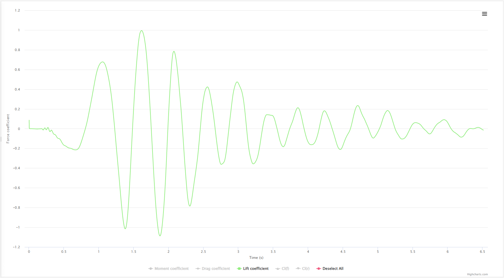

When comparing the ‘force and moment coefficients 1’ plots on both simulations, it is possible to see that for some reason the amplitude of the lift coefficient on the 5e-4s run has a decreasing behavior (reaching almost 0) that is not found on the 8e-4s run.
I am including both plots here for better clarity.
8e-4s run
5e-4s run

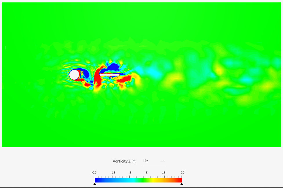

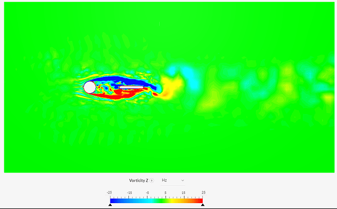

This different behavior can also be seen on the Z vorticity fields that I am also including
8e-4s run (last timestep)
5e-4s run (last timestep)
