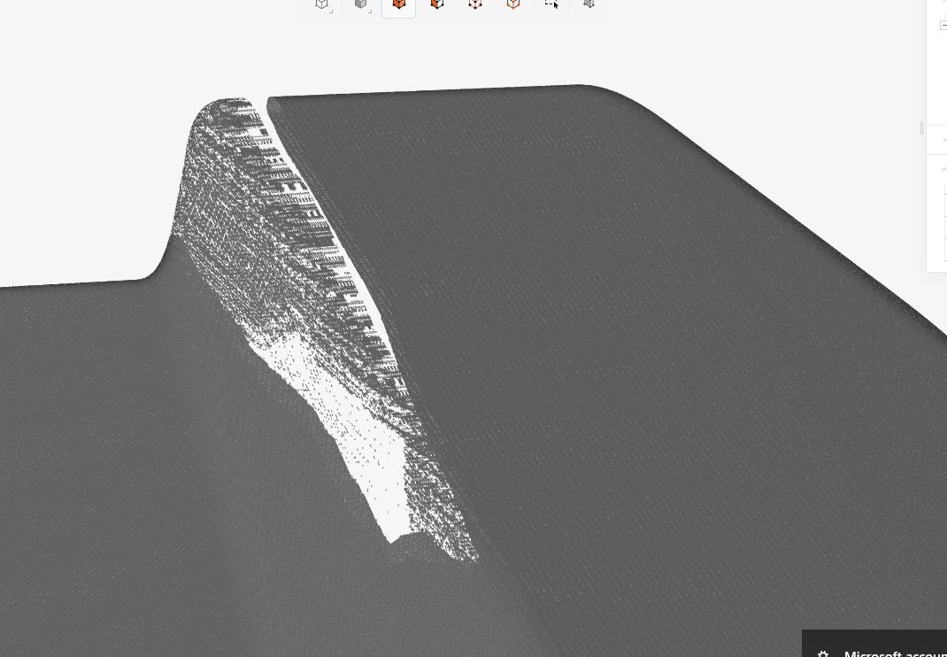

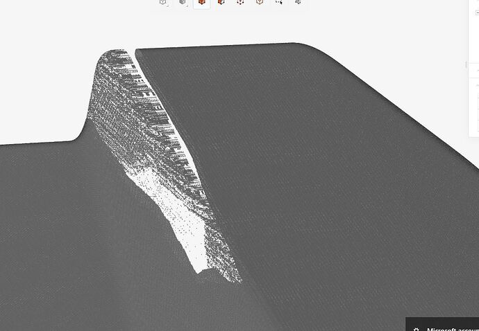

In meshing this part, the program is generating weird holes and gaps where its “pixelated” like in the picture. I have meshed multiple times and It does not do it in the same place each time.
The STL part is perfect and watertight. Please Advise

I did try doing some coarser meshes but was having poor convergence, as well as chunky looking mesh around bends. When I increased the fineness of the mesh I started getting this issue. Always happens at a different place on the part, never the same area.
