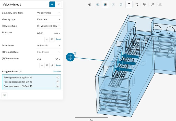

Hi all,
I know this seems like a silly question, but I can’t seem to point the volumetric flow rate (from the evaporator inlets) into the internal space / volume of the freezer. It keeps pointing outside no matter what I do, regardless if I put the volumetric flow inlet on one side of the evaporator fan (the circular face on the evaporator) or the other. And I strictly want it to be a volumetric flow, so no “just change it to fixed value instead of volumetric flow so you can control directions x, y, z” responses please. Here’s the image for reference:
Here is the project link for reference: SimScale Login
Thanks in advance to those who can help!
Hi , i am new to this platform as well, I think this is because you selected part faces instead of flow region faces, thanks
regards
VR
