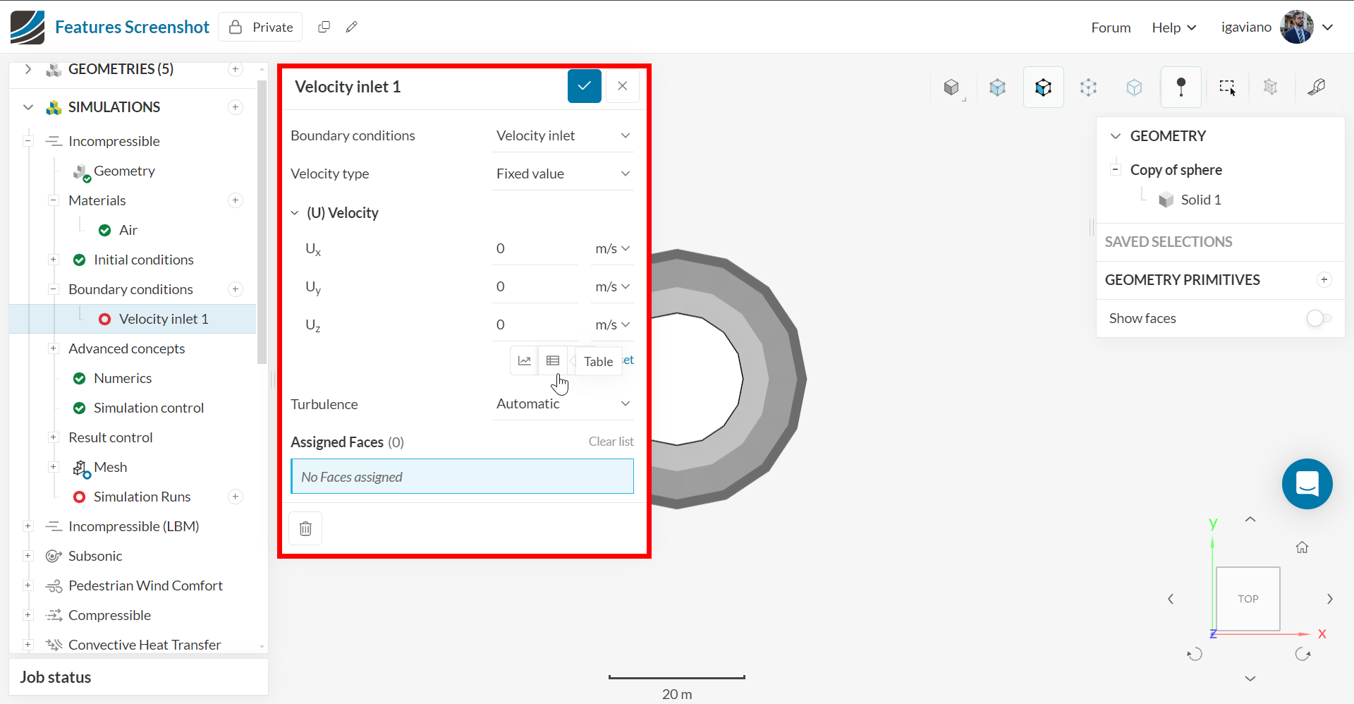

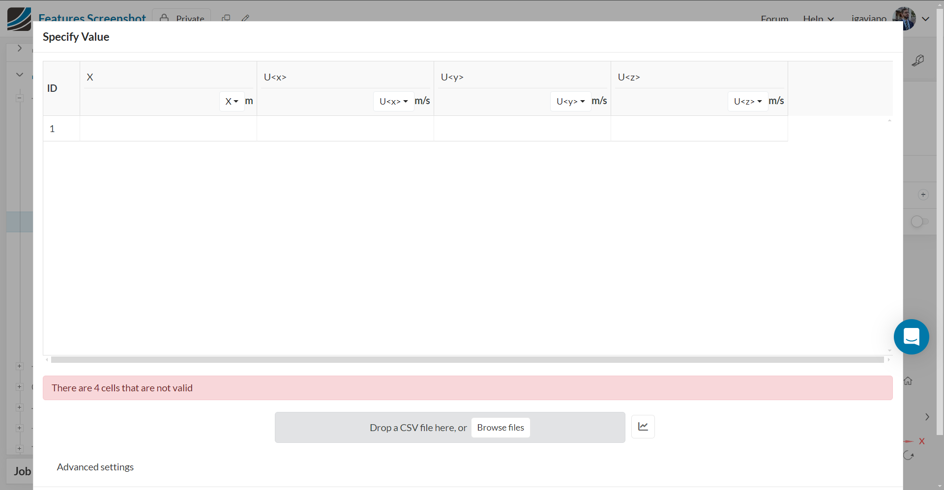

I just wanted to reach out again for a quick follow-up on your situation: what you’re trying to do would be possible if you used a third party solution such as ParaView for analysis, retrieving the point data for that particular wall and inserting it as a table boundary condition (which should only work for velocity):
Does that help?
