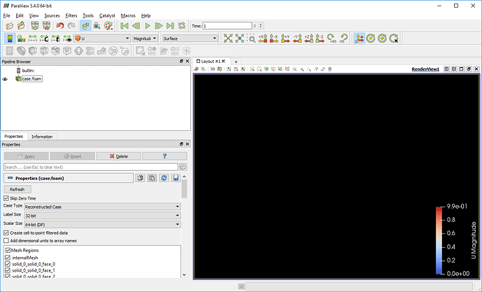

I downloaded ParaView and the results file from the SimScale Post-Processor. I load the case.foam file and Apply but I am not seeing any data. Time scale is set to 1 because it won’t go any further. I see a legend but the rest of the Layout is black. Any suggestions?
There are no output messages either.
Windows 10
#2
Found someone else who has this issue and reported it:
Disabling FXAA corrected it.
