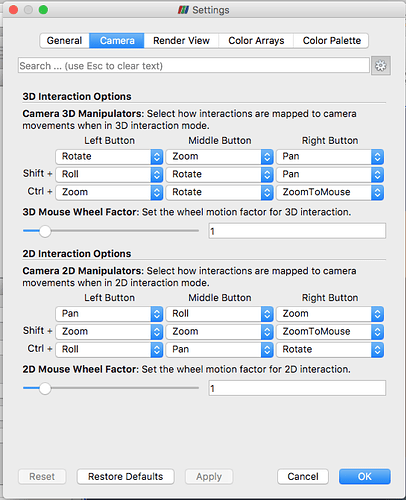

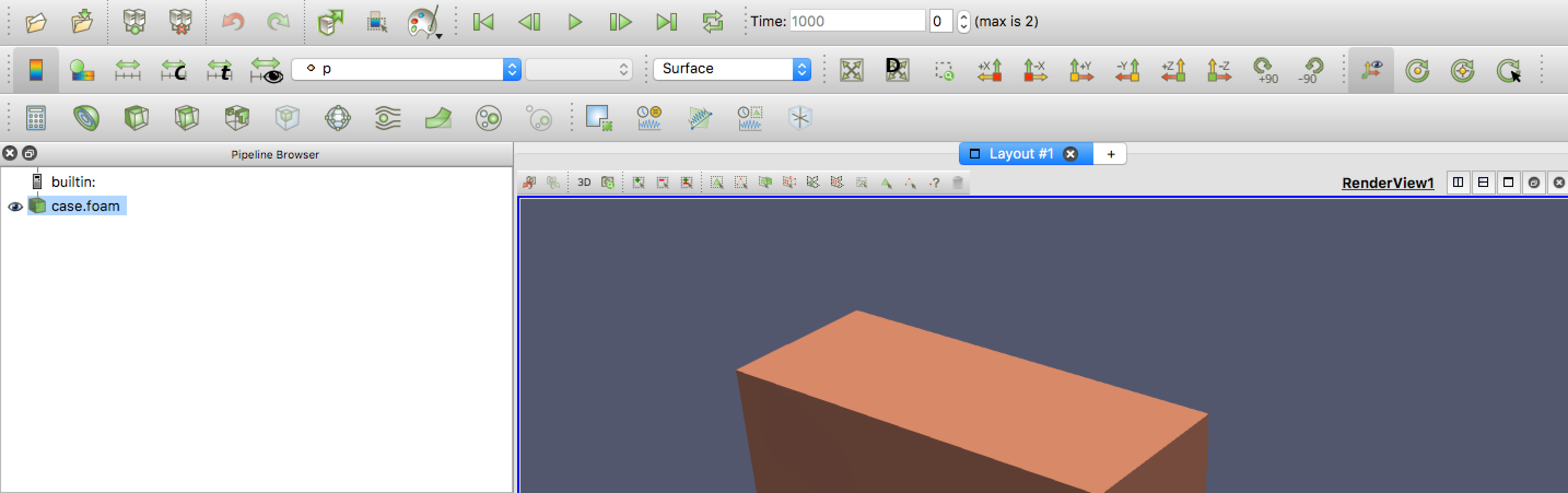

  1. Where can I set (even lock) a global co-ordinate system. I want to set the origin as being in the centre of the object, so that I can set all my clips/slices etc to having that origin. How do I do this?

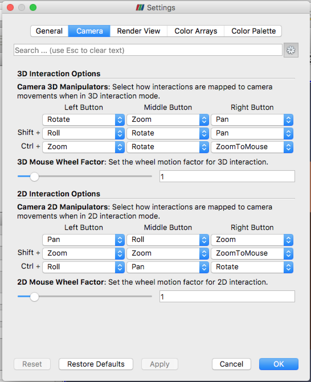

  2. Does anyone have a list of mousepad controls on a MacBook Air. I don’t have enough ports on this machine, to use a USB connected mouse. {I suppose I could purchase a bluetooth connected mouse, although I’m trying to keep my hardware light)…

The 'select centre of rotation button is this one on the far right with the rotation arrow and cursor:
The mouse controls are in properties> mouse controls, this is good to see all mouse pad controls. I set the pan to be right click on the MacBook pro and zoom middle button. Find that more natural. I also don’t use a mouse, love the track pad.
Hope this helps,
Darren
