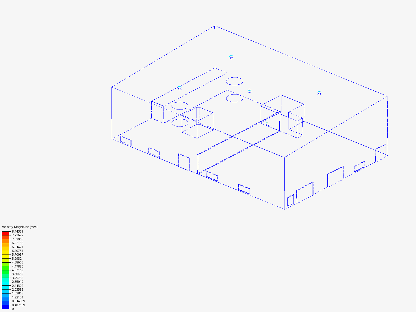

I have run a airflow simulation inside a factory to understand the effectiveness of roof fans. I used pressure inlet and velocity outlet for boundary conditions. When I try to particle trace, I can see only the outlet for placing the seed. the inlet disappears from the model. Is there a specific reason for this. Thank you all for your time.
Hello hhyder,
I’m not aware of any reason why this shouldn’t be possible.
Can you please share a link to your project with us?
Hello SBlock,
Thank you for the reply, please find the link below.
Hello hhyder,
it seems to me like this is a bug, thanks for reporting the issue, can you please share your project with the support. I’ll report the bug to the post-processing department.
Anyway, you can have a workaround by first selecting the pick icon, and after that, toggle the part visibility. off and on.
Thank you, it worked in the other method. Really appreciate your help.
