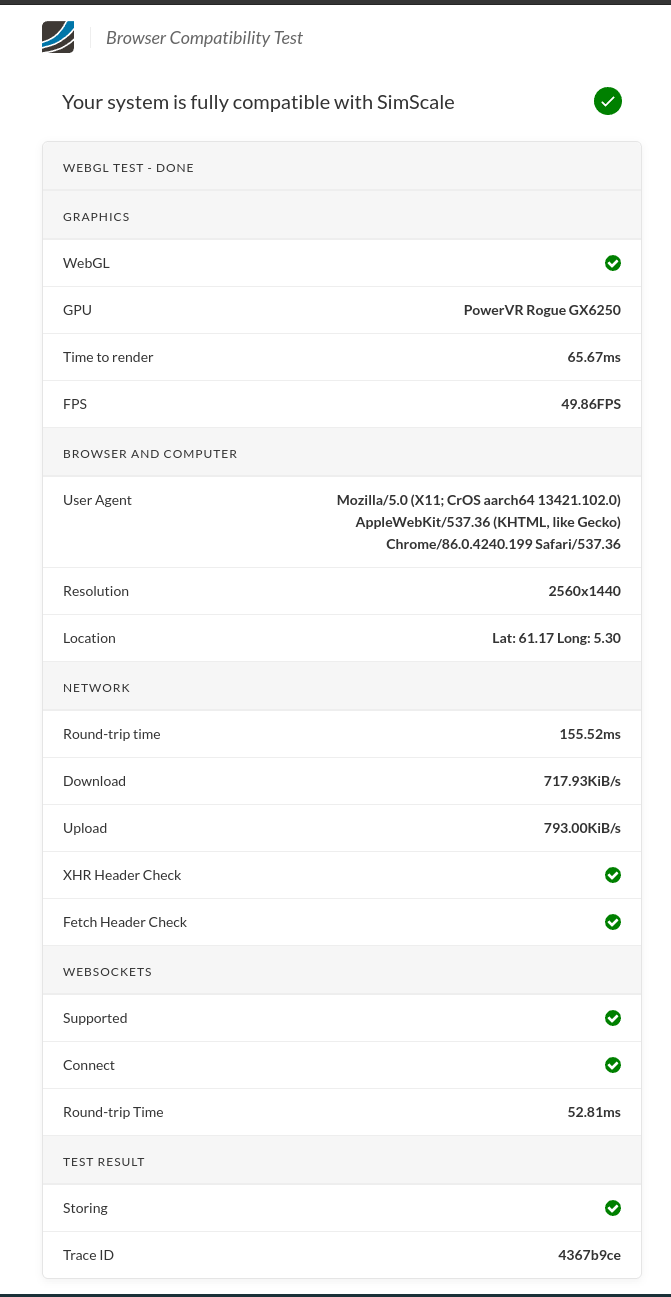

Hi Tore!
Could you use this testing page and see what it says? SimScale Compatibility Test Page
Keep us posted! :slight_smile:
Thanks for your reply.
The test page does this:
I tested some more, and achieved this:
