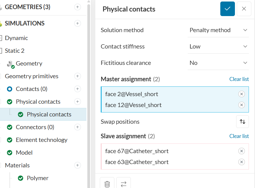

  • I have tried penalty contact, AL method and fictious clearance

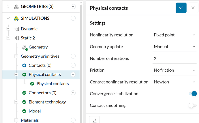

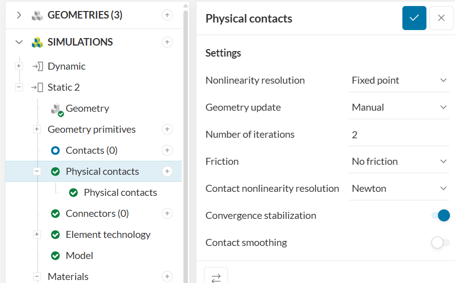

For the physical contact global setting, I’d suggest initially going with a more robust setting and then building from there. Something like this:

I adjusted all the other parameters as per your suggestions including changing the BC to rotating motion.
