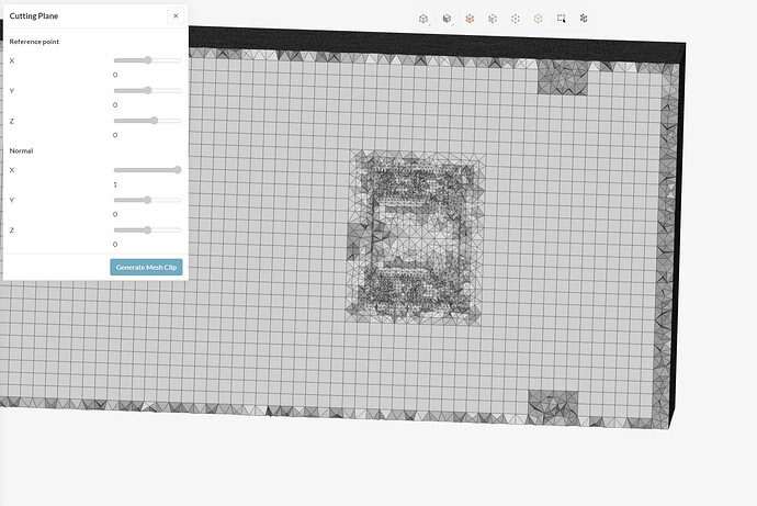

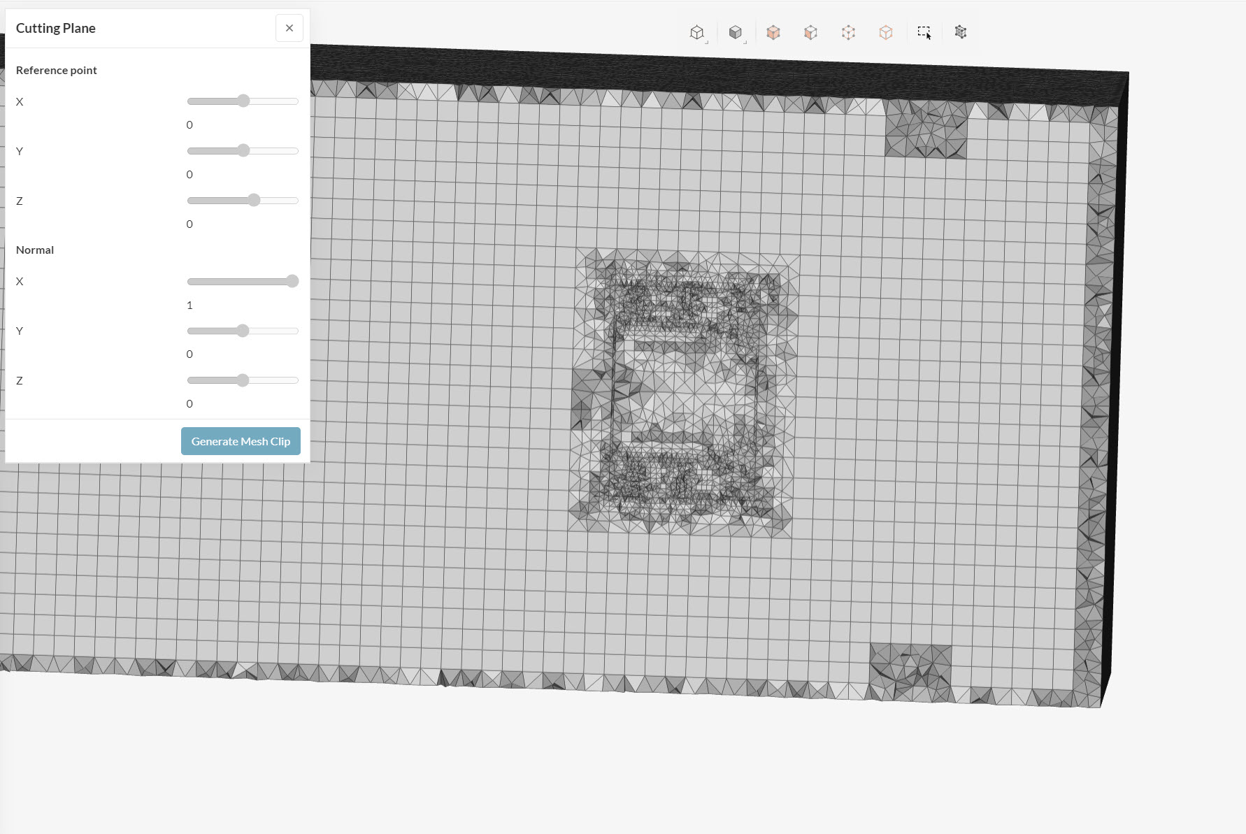

Hi there, thank you for using the forum! I have some comments regarding your case:
  1. The mesh is pretty coarse, try to increase the fineness, and maybe add a few refinements as well
    Standard Mesher | Meshing for CAE | Documentation | SimScale
    How to Check and Improve Mesh Quality | SimScale
  2. Try to increase the domain’s size :smiley:
  3. Can you explain to me the reasoning between the Custom boundary conditions instead of the ‘Slip wall’?
Also, 20000 degrees/sec does not correspond to 20000 rpm, so you might want to check this. And for these high RPMs, we would have supersonic flow, right?
