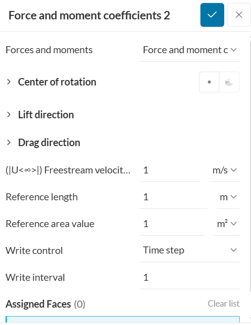

I am going trough the formula student and following the tutorial and when I was going to add forces and moments coefficients I was supposed to add lift drag and pitch and pitch is missing. Can i get some help on how to resolve this because the chat bot said to post here. I am currently working on a recruitment task for a formula student team and I dont have much time so a quick response would help.
The UI in the tutorial seems to be slightly outdated. Now the pitch axis will automatically be normal to both lift and drag, so you won’t need to explicitly set up the pitch axis in your project.
