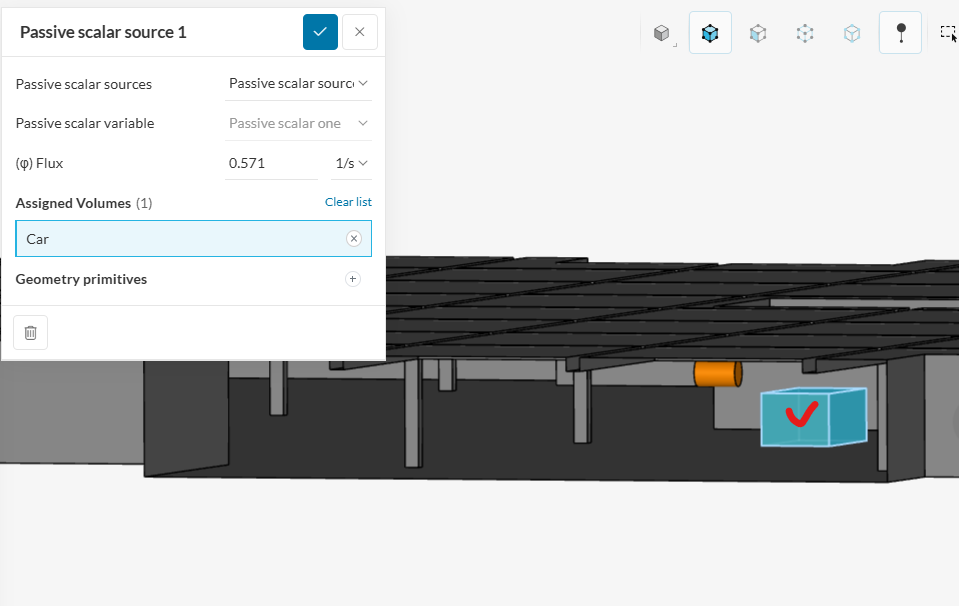

Hi All,
How can I add heat flux to car in this example with passive scalar? thanks
The tutorial uses the incompressible solver, which is isothermal, so before you can add heat sources you would need to use Conjugate Heat Transfer instead.
You’d be able to define heat sources with e.g. Advanced Concepts > Power Source.
