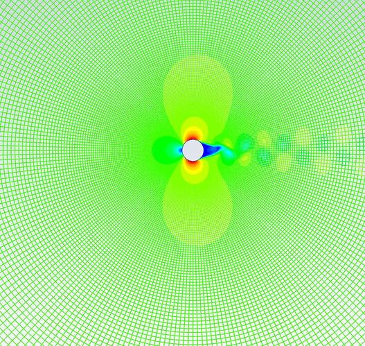

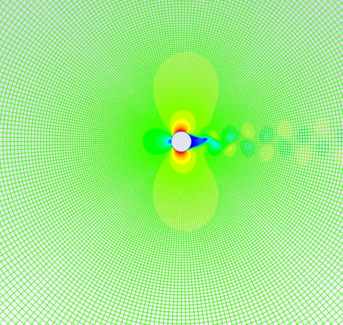

I have to simulate a turbulent flow past a circular cylinder. I choose the SST k-omega Model. To become Re=12*10^6, I ch
ose the density 120, the viscosity 0.001 and the velocity 100, than I choose the boundary conditions for Reference Values and Initialization.
As a Time Step Size I took 0.0004 s, 10000 Number of Time Steps and 20 Iterations
In the attachment you find my result after more then 8 hours.
I must get a Drag number arround 0.6 but I got 0.2 .
I hope if someone has some advices :slight_smile:
Hasnaoui

That does look like an Ansys mesh.
Do share the project link so we can look at it. (@mhasnaoui).
