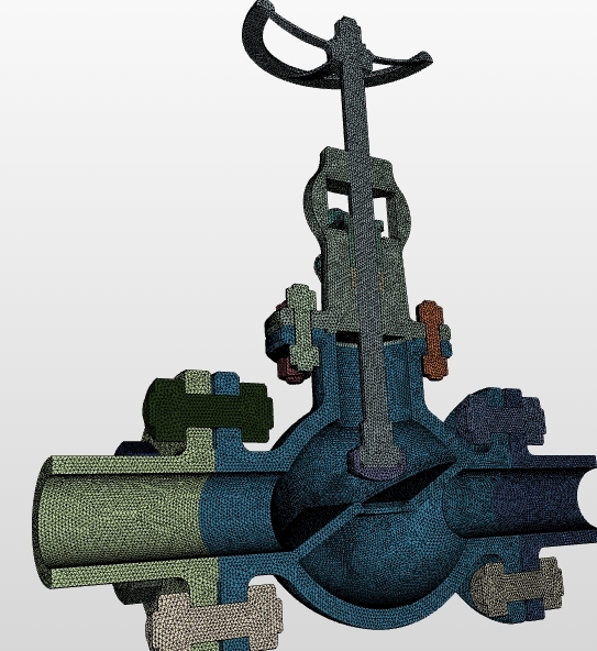

Type of analysis: Thermostructural Analysis - Uncoupled thermomechanical analysis (advanced)
Solver: Code_Aster
Transient or steady-state: Transient
Static or dynamic: Static
Nonlinear Analysis: True
Mesh Type: Tet-dominant
Number of cores used for the simulation: 32
Computation time: The analysis ran for a total simulation interval of 468 sec. (7.8 min.) on a 32 core machine and took around 323 min. to complete.

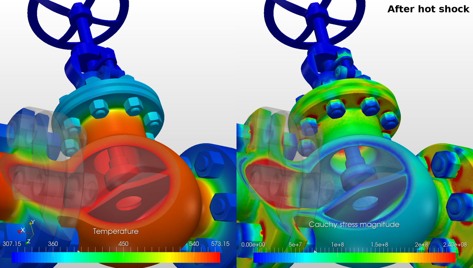

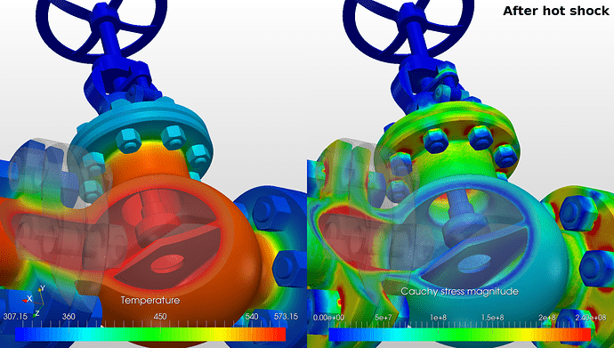

Post-Processing - Temperature and Cauchy-Stress After Hot Shock

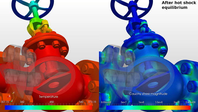

Post-Processing - Temperature and Cauchy-Stress After Hot Shock Equilibrium

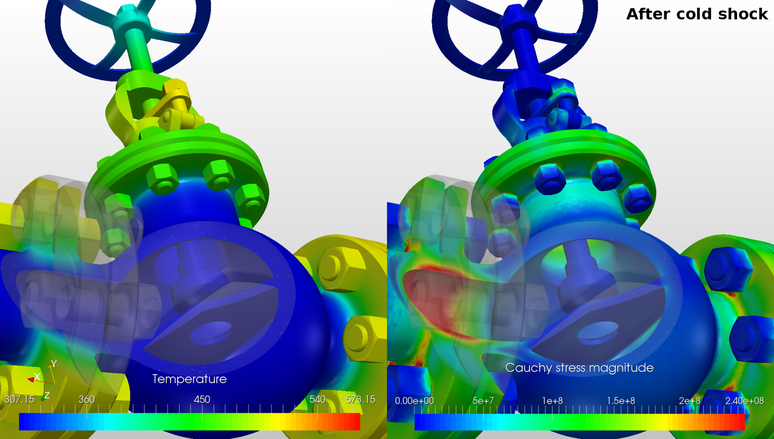

Post-Processing - Temperature and Cauchy-Stress After Cold Shock

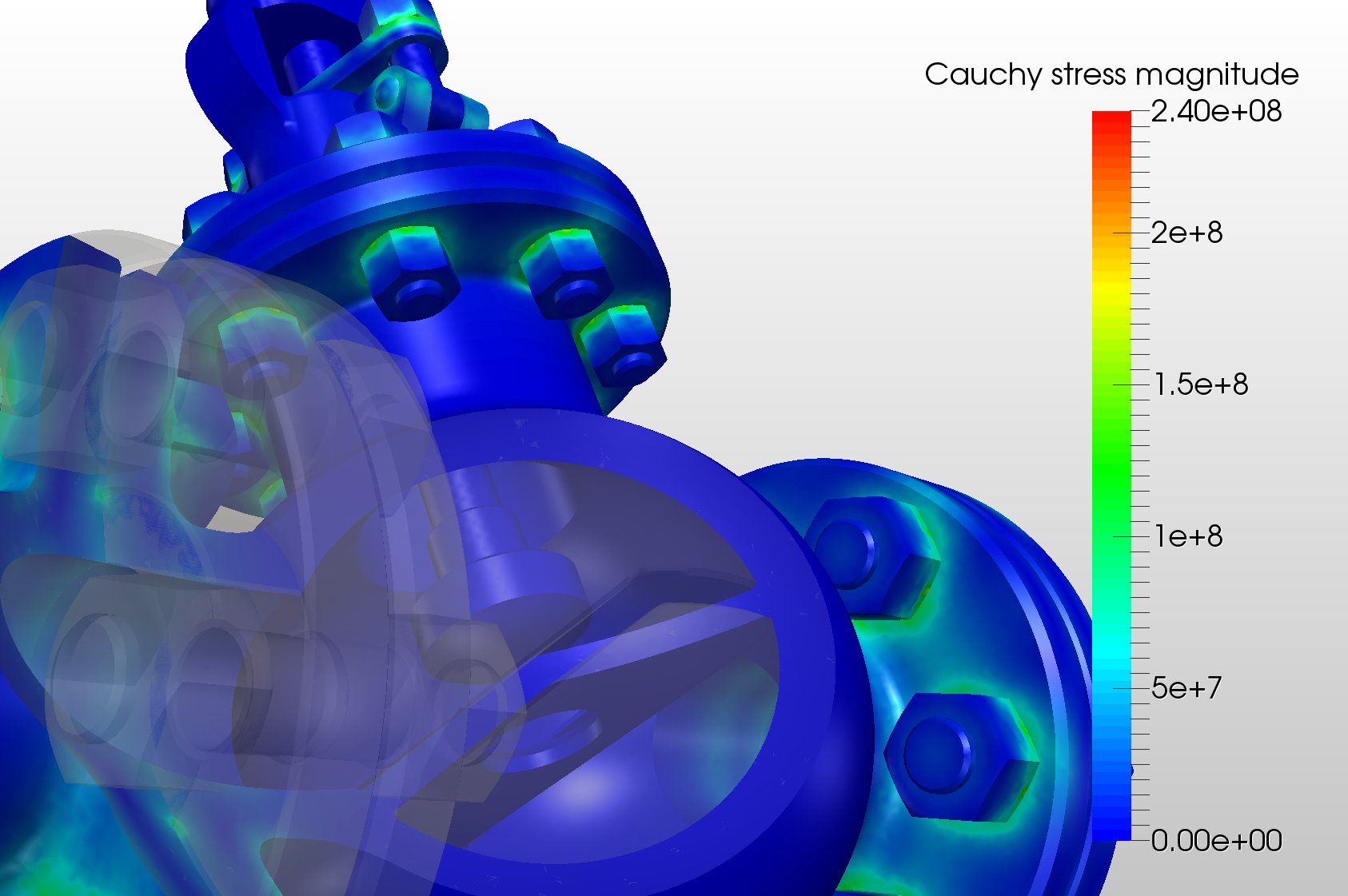

Animation of the Post-Processing
